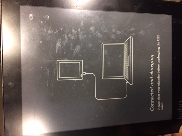

LED goes on for about 10 sec when I connect the external power cable, otherwise it is OFF, no matter what I press.
screen photo is attached. Charging it for over an hour, no effect

I don't see any damage to screen.
One more test, reconnected the battery wait 20 sec until the LED stop flash, and check light button, if light is turn on/off the problem is with the screen.

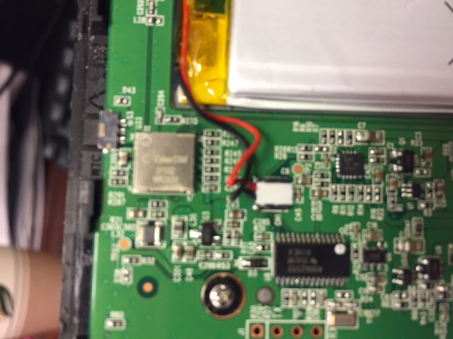

There is only one way to connect the battery. It is snug in place. I took it out and back in several times. The LED doesn't come on. I am not sure if it should.

I used it yesterday, the battery was not empty. Even on the frozen screen it is shown as not empty. I do not see any physical problems with the battery or wires.
