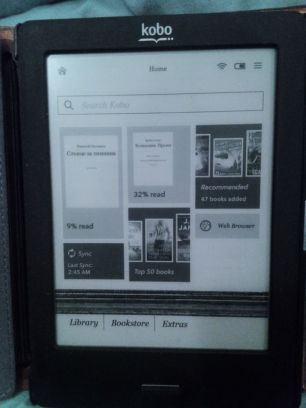

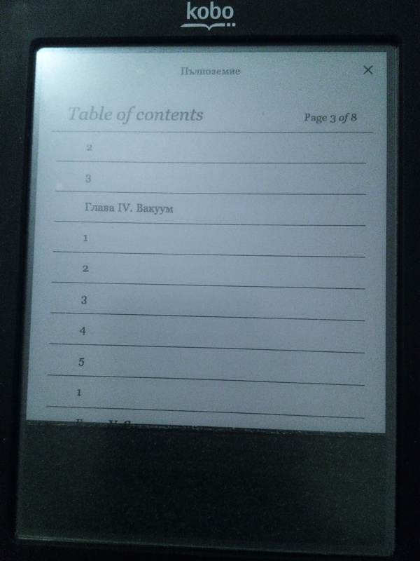

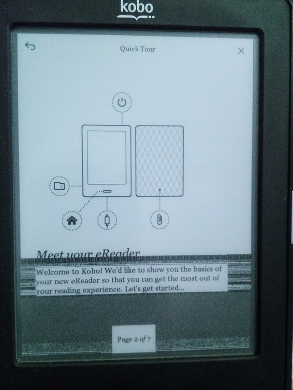

Hello
This new update screwed up my device.
I just don't know how to explain it.
These lines appear randomly with no apparent pattern, mostly in the bottom of the screen and sometimes the refresh doesn't get them away.
What should I do, I never messed with my device before?
