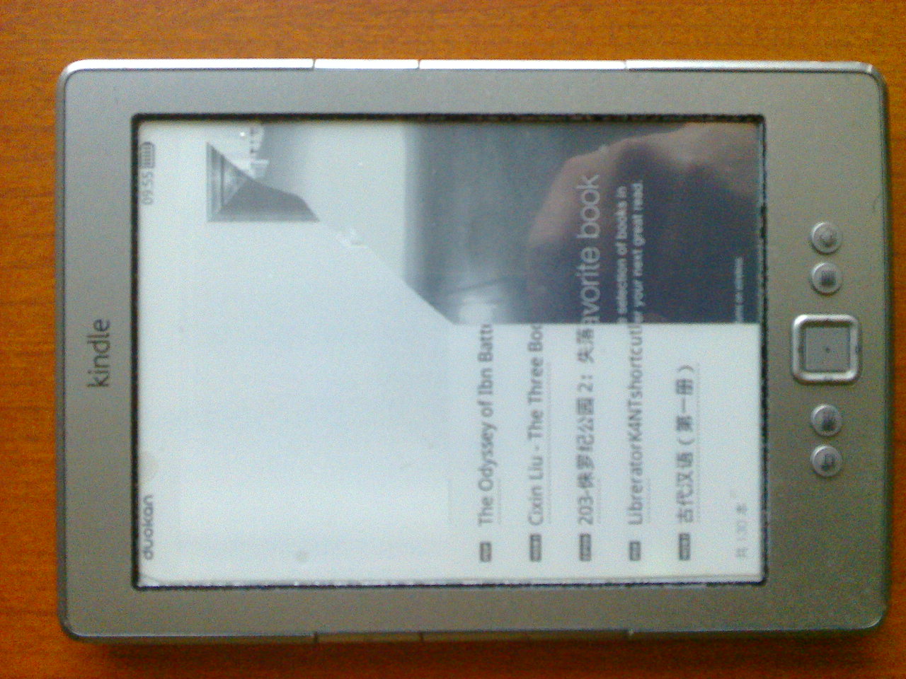

i accidentally dropped my kindle 4 NT onto ground, now the screen is all messed up (see attached pic). it's broken to three areas. top half is blank, and the right side display screen saver, only lower half display text. Screen isn't damaged though.
any way to fix it?

You photo looks like a classic case of a broken e-ink substrate inside the screen. It is quite fragile.
It is possible to replace the screen, but it will probably cost more than the kindle is worth.

2. a tougher screen than K4NT
Currently any eInk screen (except the $$$ plastic substrate 13.3" ones) is going to be just as fragile. All of them use a thin glass backplane/substrate which can break if dropped just right or subjected to any kind of twisting force.

Yes, the Voyage has a glass front as opposed to plastic on most other devices. All eInk screens (for the most part) have the thin glass substrate though. This is what usually breaks. The Voyage's glass front may help with any kind of direct pressure put on the screen breaking the substrate (like something pressing against the screen when carried in a bag), I'm not sure.
