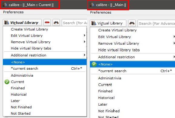

Press Alt+R and select None from the VL button drop down, viz
Also tap the Escape key to clear any active Search.

are you seeing the Red Minus button in BR's image? That means a VL is being shown
Also the Status bar at the bottom of Calibre will only have 2 Values (books, selected), not 3 (books, selected, total)
If you only see 2 values, you did something to make them go bye-bye

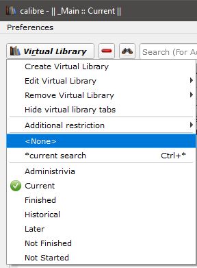

The red minus is only shown when there is an active VL. In my screen shot my 'Current' VL was active at the time. When I select 'None' it goes away. When there is an active VL it's name is shown in the Title bar after the current Library name, when there's no active VL nothing is displayed, viz:
