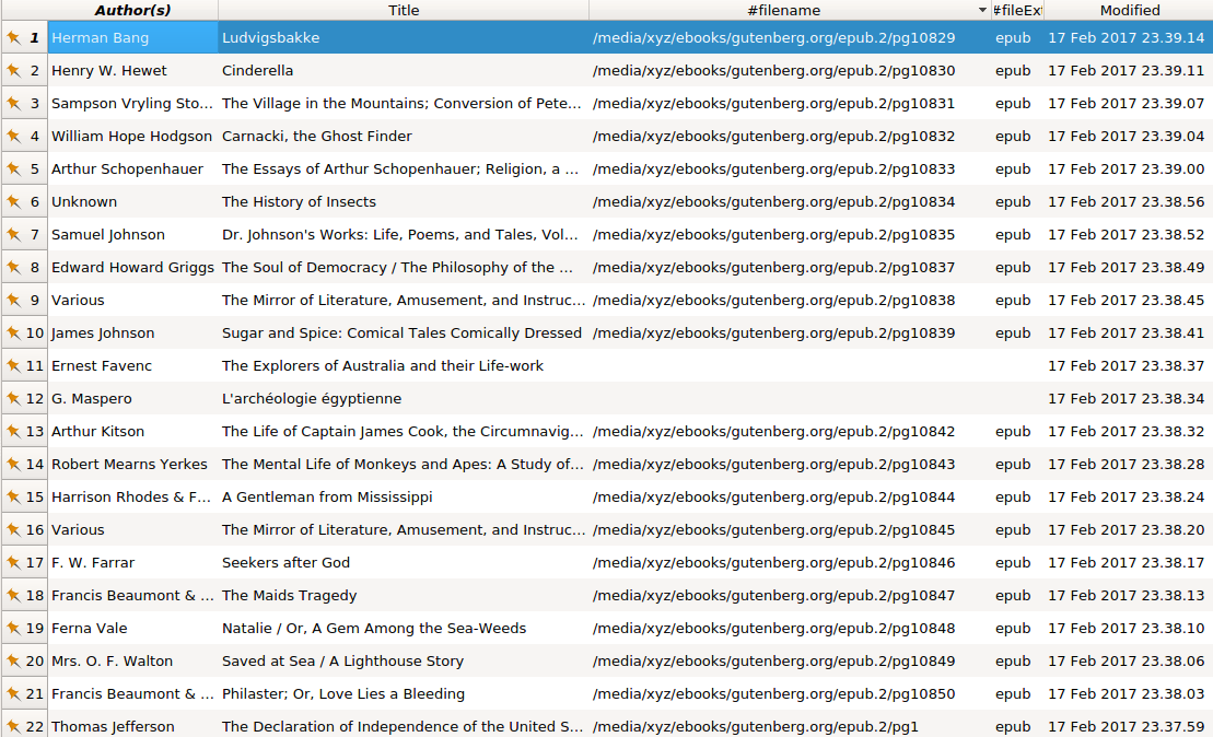

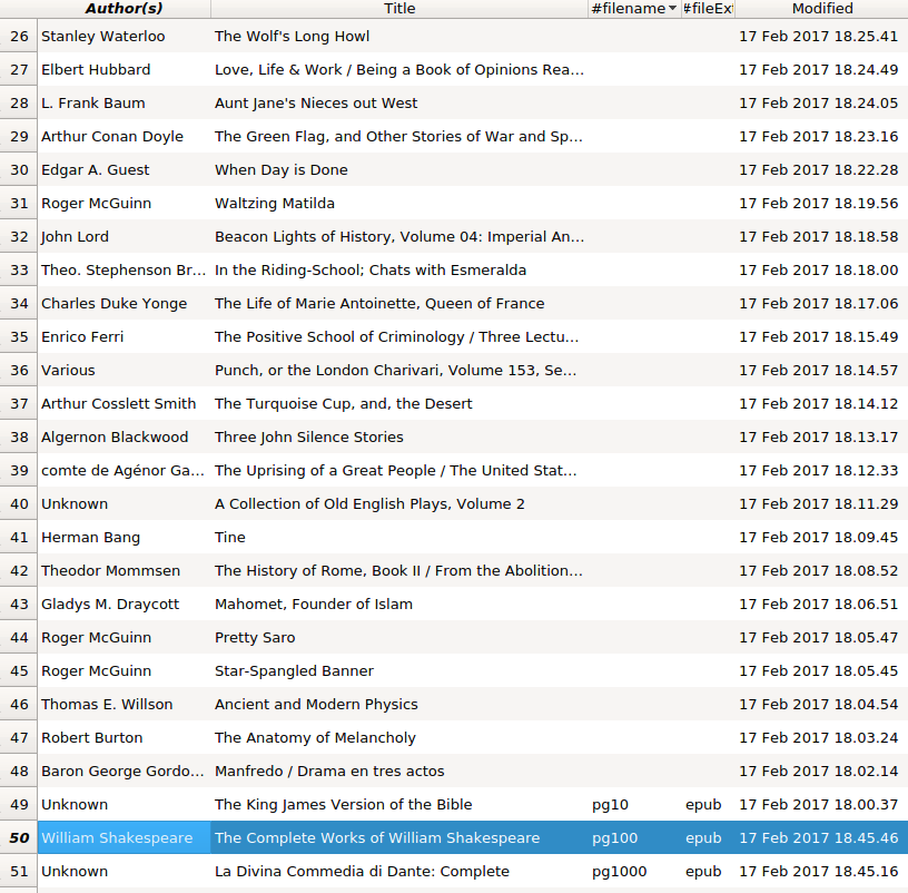

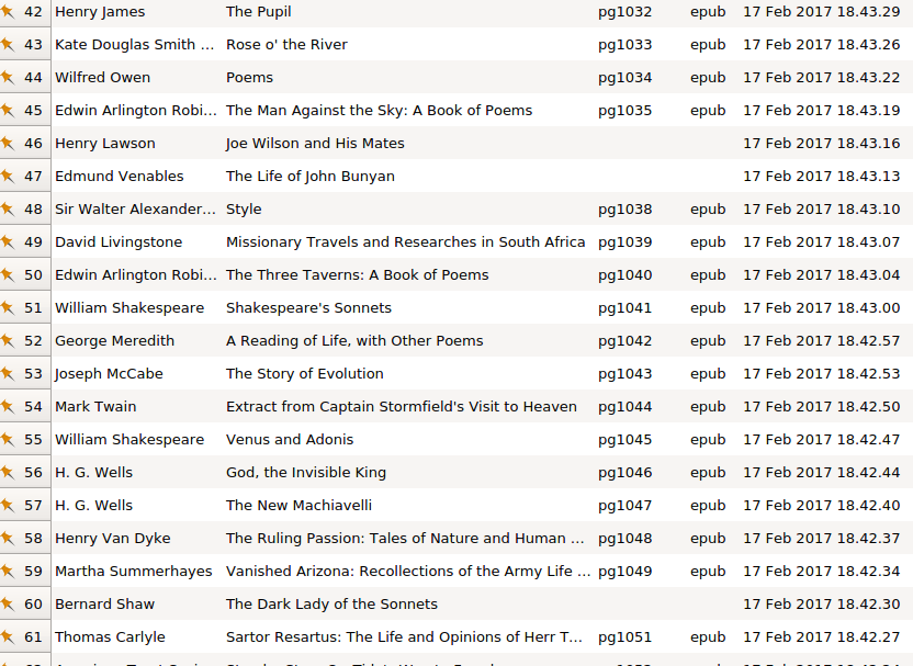

I would like to recall my first message into memory:
Originally Posted by AnselmD View Post
Some weeks ago, i started to import epubs in a bulk. I recognized, adding books with the options "add from a single directory" does not work always. Some books did not get a filename. Changing the strategy to "automatic adding" and it works perfect.
Since yesterdays i am not able to use this workaround. Pushing 3700 files to the automatic directory, leads to an
[Errno 24] Too many open files
see:
Bug #1664978 “[Errno 24] Too many open files / automatic adding...” : Bugs : calibre
https://bugs.launchpad.net/calibre/+bug/1664978
So i tried it again with (Version 0.0.11), using "add from a single directory".
But the result was, 20% of the books (all epub) has no filename.
This is the same result I recognized a few weeks ago, this drops to 0%, using automatic adding - which i can not use any more.
I have to supplement it: with auto adding it only worked, if I put the books to the auto folder, before I start calibre. If I moved a lot of books to the auto folder, while calibre is running, I also got missing filenames.
AnselmD is offline   Reply With Quote
