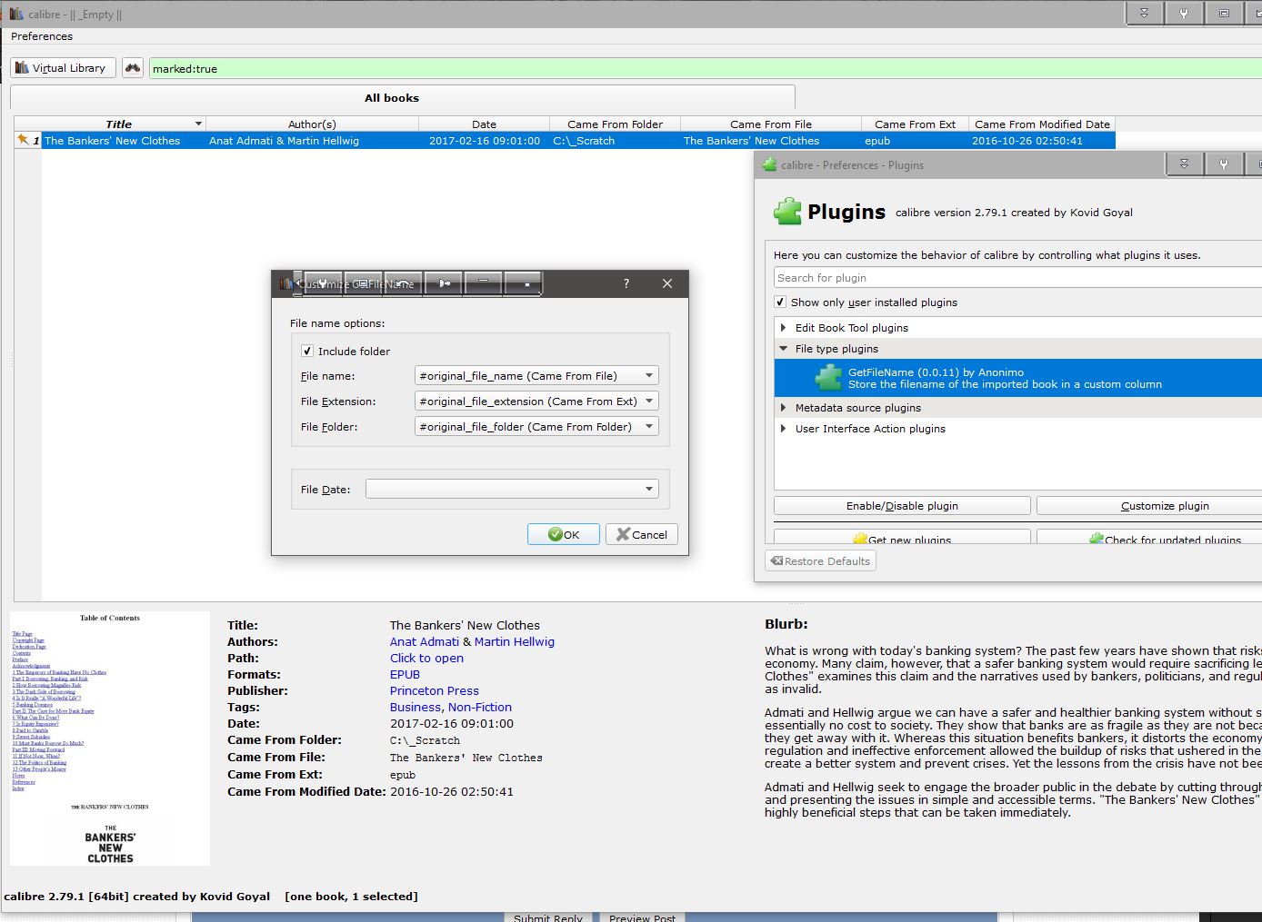

Originally Posted by Rellwood View Post
I cant remember the exact term, but its when Calibre decides that the column is not able to be changed or modified by the user.
Calibre has two column classes - built-in and user-created. The latter are distinguished in Preferences->Add your own columns by the presence of an ionic column icon alongside the Column header name and a '#' preceding the Lookup name.
I have never known calibre to reclassify a column from user-created to built-in or vice-versa. Nor, in the almost five years that I've been active on the MR Calibre forum, have I seen any posts suggesting it happens - until now.
Are you saying that, if you give the column the name "original_file_path" or "original_file_name", then they are not custom column anymore? No, I didn't know, I've never used a so long name.
@Terisa de Morgan - I've used those exact or very similar lookup names with no problems. See attached screen shot.
I just noticed a glitch, you'll notice the File Date in GFN configuration is empty. But it is set, to #original_file_date/Came From Modified Date. As you can see, the file system modified date is stored in that column. So it's a problem in displaying the current setting for File Date, not in setting the value.

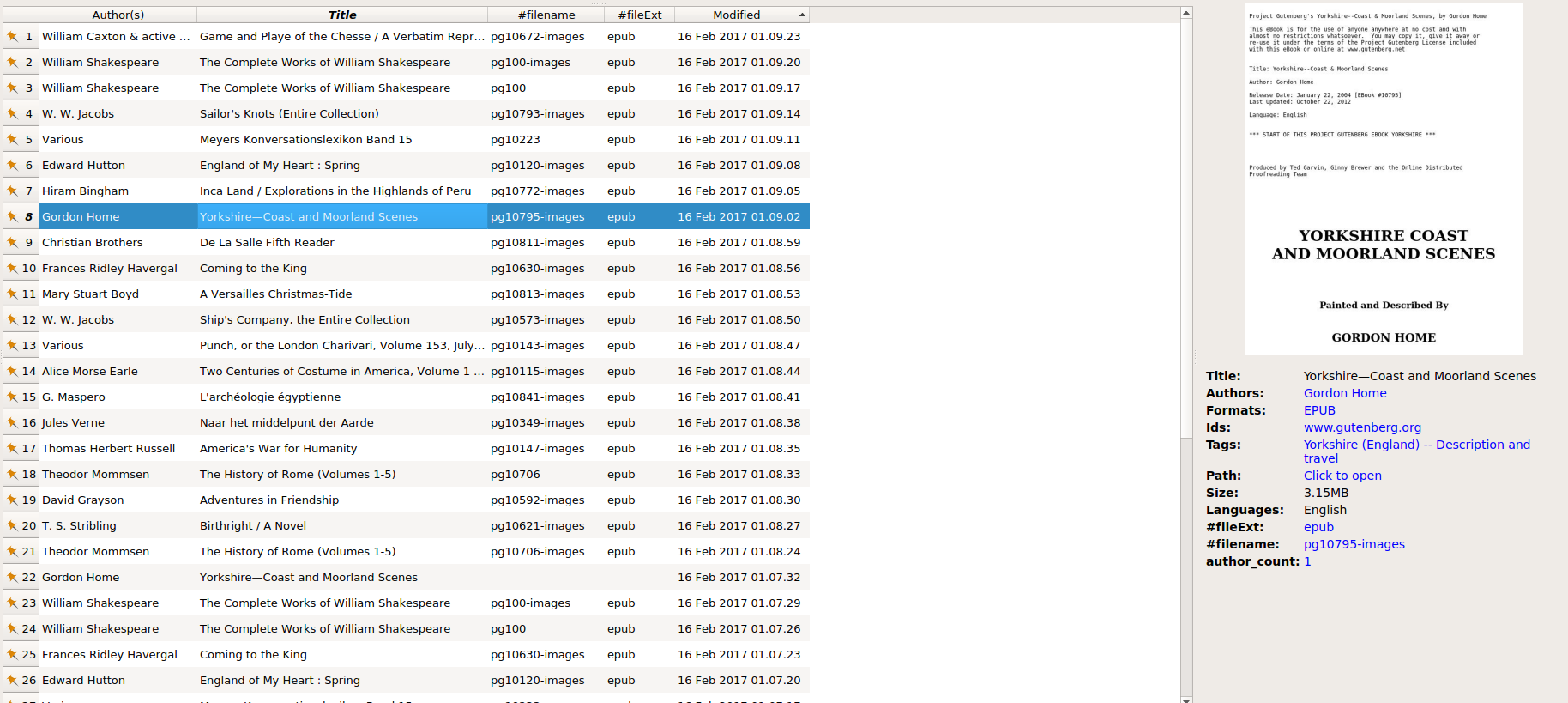

For knowing which the problem is, I would need a debug log of a session with failed files. Unless I have that, I can do nothing.
I added 21 files of the gutenberg project. I did it several times and the result is different. Typically between 0 and 3 books have missing filenames.
When is was ready to create the log, i got always a correct import. But now I can show one with an incorrect filename.
I imported the 21 books two times to demonstrate both are different. By the way, i did not see any hint in the log. Did you test, if the database update was successful?
Yes, the exception is treated. Anyway, I'm going to add some more logs and I'll update a temporal version, so if you want you can test it and I can see which the problem is.

Old 02-16-2017, 07:06 AM   #114
AnselmD
AnselmD began at the beginning.
Posts: 105
Join Date: Oct 2013
@AnselmDIf you can test the plugin again with this version, I hope the debug can give me more information. I apology for the annoyances.
Hi @Terisa de morgan,
I imported more epub books, so I can hit the difficulties in one import.
1586 book imported, 202 filenames missing.
Sort after modified date, a gap of 8 books (such "larger gaps" are typical):

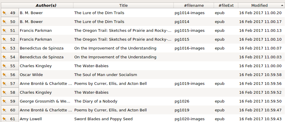

The next gap:
Name:	Screenshot from 2017-02-16 11-41-52.png
Sort by column #filename
Name:	Screenshot from 2017-02-16 11-42-55.png
No hint for me in the log:

Checking the logs, it looks like you try to add the same file more than once and the second one fails. I¡ll try to check a similar situation at home.
I did it again without duplicates Terisa, it does not make a difference:
