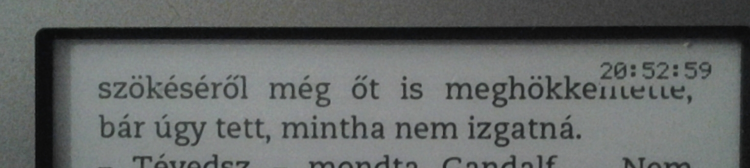

Thank you for this useful extension!
I tested it on an original Touch and a PW2. It worked on both, but unfortunately the top of the first line of text was obscured on both devices. Is it maybe possible to move the time display more to the top/decrease its font size?

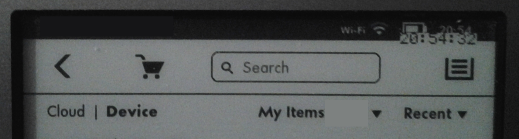

Also, on the Touch there was some interesting behavior:
- the display is constantly visible, even when not in book,
- on page refresh sometimes the seconds keep going for a few seconds,
- sometimes the extension stopped working after exiting a book, had to restart manually.
Lastly, would it be possible to not show seconds?
Thanks again!
anduska is offline   Reply With Quote

Hi Anduska,
can you post the showtime.log from the extension folder and some screenshots showing the problems.
As fare as I know I can't change the font or font size of the command that I use to write on the screen. I can only change the position. As I do not have a Touch the current position is not tested.
This should not be the case. I would need some more information to fix that.

I've attached the log files and pictures for both devices (sorry for the quality). As you can see, on the PW2 only a few pixels to the top would be enough, on the Touch a little bit more.
If you are asking, I vote for no seconds and no battery display

Originally Posted by anduska View Post
Hi HaPe,
Thanks for the quick feedback. I think about making it configurable if you what to see the battery level. Seconds make no scene at all, as they wont be right all the time.
About the problem that you see the time on the main menu of the Kindle Touch. Dose this happen after all actions in the main menu or only on some actions?
I will include a function in the next version to save the /var/log/messages that is used to find the page turns. Hope that we are able to find the wrong once and filter them out
