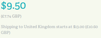

Hi knc1, I hope I can assure you that I've read that tutorial and many other posts on this forum as well. In fact that 'international' Tindie link is exactly what I was talking about - if you look at the item plus shipping, it is the $22.50 that I referred to above!
Appreciate your comment about being headed for trouble, if it sounds like lunacy then I'll definitely scrap this plan of action, what would you see going wrong, providing I check before connecting that the outputs are definitely 1.8V?
