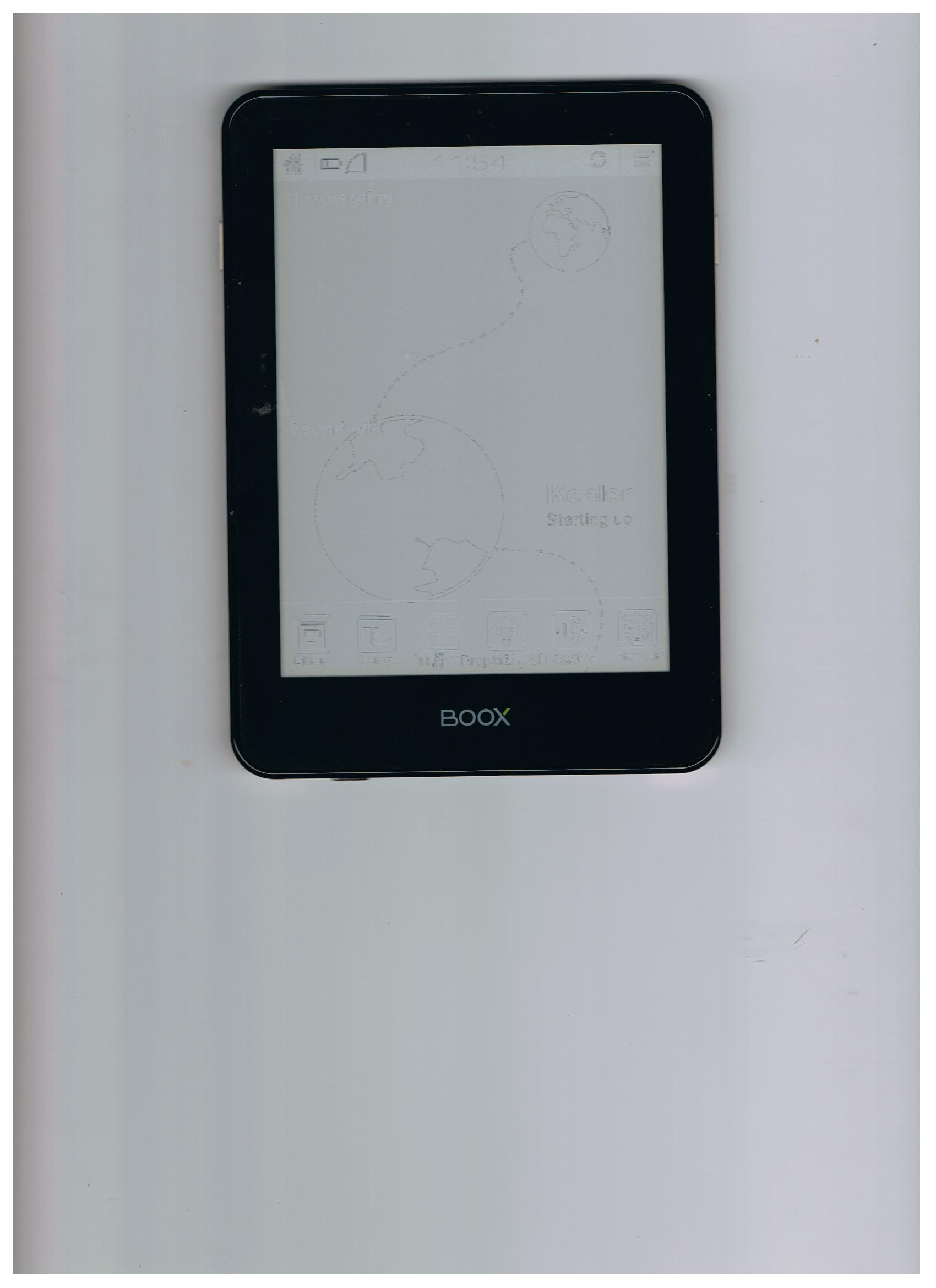

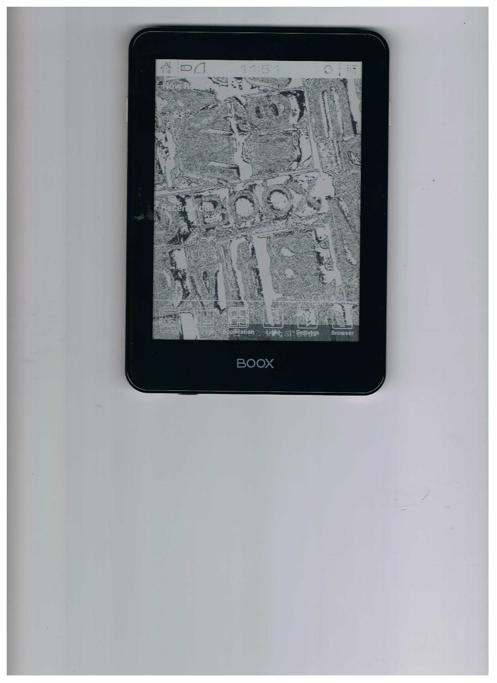

Originally Posted by cwright View Post
I don't know if you've tried this or if it will work for a device that isn't quite right anymore, but since I lost the "refresh" button I've been using the cover for refreshing the page in apps that aren't so great about refreshing automatically (such as Kindle) - i.e. close the cover so that the Kepler goes to sleep and then reopen and it automatically reloads the same page that I was on, but it's then refreshed. It's about as fast as using the refresh button before.
The cover puts the screen into, then out of, sleep mode. However, as this has a fairly dense graphic, and overwrites rather than refreshes, it just makes matters worse.
Last night I got a further response back from Onyx. Based solely on the above pic, they'd jumped to the erroneous conclusion that the screen was damaged. Luckily, I found that my eReader had become responsive again in the interim, and I could provide pictures providing evidence to the contrary.
They show respectively, the screen (i) in sleep mode, (ii) just out of sleep mode & (iii) when first started up. I also was able to present them with a (rather hurried and thus blurred) pic of the initial "BOOX READER" screen showing at full contrast (meaning that neither the screen, nor the most basic OS is damaged).

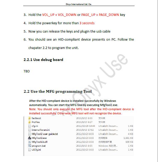

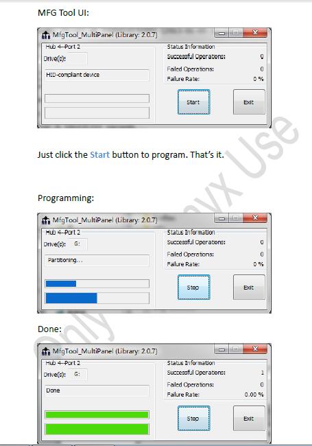

You can try to root the device, please download and unzip the file and tool from this link http://oa.o-in.me:9002/f/92cc614ff5/
Attached is the instruction, please refer to it. If the device can not be recovery, please arrange to send it back to our following address...
(I'm attaching their instructions, in case anybody wants to root theirs -- use at your own risk, o'course.)
As previously mentioned, 'Download' mode isn't working, so I'm returning my eReader to them.

WOW! I'm flabbergasted - what you got there is some sort of internal development tool!
I have tried to start it up and I think you should try again, too:
All you have to do is turn off the device & connect it to your PC. Then hold both page turn buttons and press power for three seconds. Note: you won't see any change on the ereader screen, but the device should show up on your PC's USB connections as something like "Freescale Semiconductor, Inc. SE Blank MEGREZ". Then you should be able to use their tool, whatever it does exactly. Obviously, I haven't pressed "Start" in the tool since I'm afraid it might wipe my data. You might as well try though before you send it in. I'm not even sure whether this is a rooting tool, but thanks to WithACee we now also know how to root the little critter ourselves, which I will definitely try soon as well
For all it's worth: with this kind of low-level access to the device I'm now completely happy, so your bricking mishap helped at least one person So thank you so much for sharing the files!
And of course, please let us know how this works for you...
sharkcow
Edit: haven't even begun to understand all you can do with that tool, but here you can find the official documentation:
http://www.nxp.com/assets/documents/...LMFGTOOLUG.pdf
Edit2: if you want to know what the start-button in the tool does, take a look at ucl2.xml. From a first look and since this is the manufacturing tool for the device, I conclude that it will re-flash the device, i.e. do a complete factory reset and format all partitions, so you _will_ lose your data. If the device doesn't work afterwards, your hardware is broken. I don't see that this tool roots the devices, though.

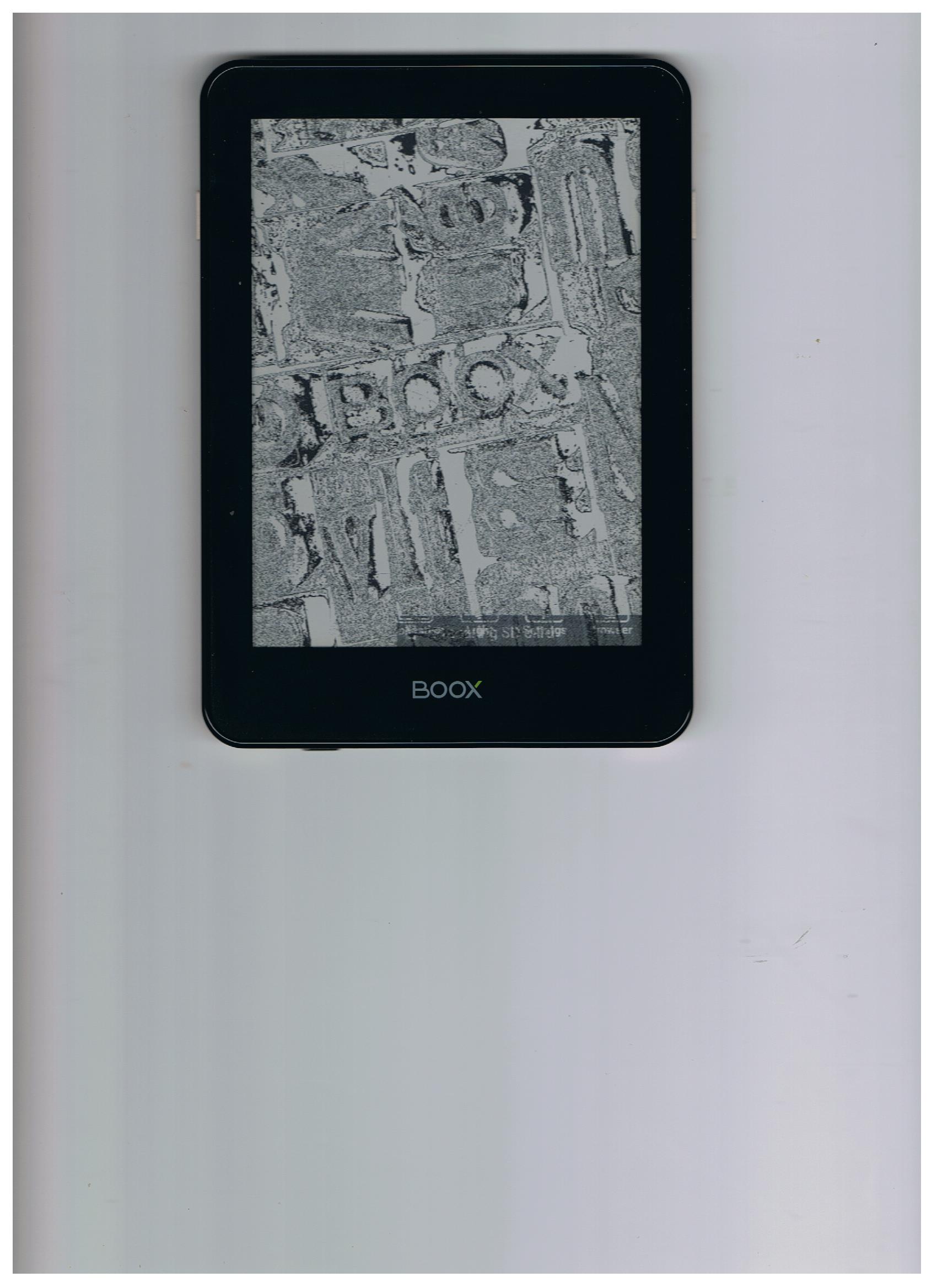

As I stated earlier, 'Download' mode (and in fact all three debug modes) aren't working on my eReader. If I hold the power button down for the instructed 3 sec, it just boots into 'normal' mode, if I hold it down for longer, it becomes non-responsive for hours/days, but does not present as an 'HID compliant device' when connected to a PC.
Given this, and the fact that (more than a day after my previous attempt) my eReader was still unresponsive, I sent it back to Onyx Boox yesterday.
Given the sequence of events (1st flash: slight problem (Google Play doesn't work); 2nd flash: severe screen problems; all further attempts to get it into any debug mode to further reflash giving idiosyncratic results), I'm beginning to suspect that there is some flaw (hardware or software) affecting this particular device's low-level functionality, with reflashing attempts causing the problem to 'snowball'.
