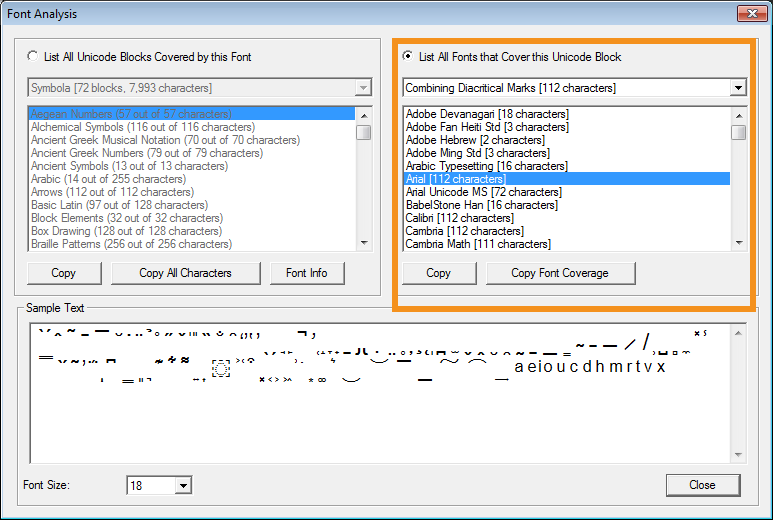

You could also use BabelMap to figure out which fonts installed on your computer have support for that range:
http://www.babelstone.co.uk/Software/BabelMap.html
Press Fonts -> Fonts Analysis Utility. Then make sure you click List All Fonts that Cover this Unicode Block + choose Combining Diacritical Marks in the dropdown:

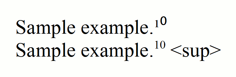

Side Note: Most fonts don't even have the Unicode superscript numbers, let alone the superscript letters. Plus the letters are split across many blocks... because their use case is mostly for highly specialized Linguistics [IPA/UPA], NOT everyday typing.
Side Note #2: Another thing to look out for (besides the superscript characters missing in most fonts) is completely crap kerning/placement. So you can get really atrocious looking things like:
Sample example.¹⁰
Sample example.<sup>10</sup>
