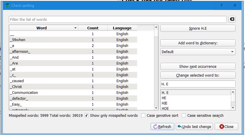

Spell check works pretty well and normally finds a correct choice of corrections
However, when I'm stepping through spell check to fix mis-scanned words (almost always with a count of 1) and when I click [Replace With] SC seems to refresh (takes a while for long books) and repositions to the first entry again. So I have to wait and the scroll to find the word after the one that was just replaced
It'd be a lot faster and easier to just replace the text without refreshing automatically and position the line in the errors to the next misspelt work
Is there any way or setting to do that, or is a program enhancement required?

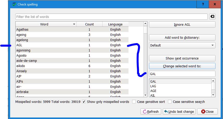

I think the [Rechecking...] was because I almost always edit in the text since I either need to see the word in context, OR the misspelled word scrollbar is not updated (CAPTURE3 and CAPTURE 4)
If you [Change selected word] (CAPTURE3.JPG), the high light scroll bar doesn't move/refresh to what appears to be the PREVIOUS word in the list (CAPTURE4.JPG), but the Suggestions do. I think it really should highlight the NEXT word on the misspelling list.

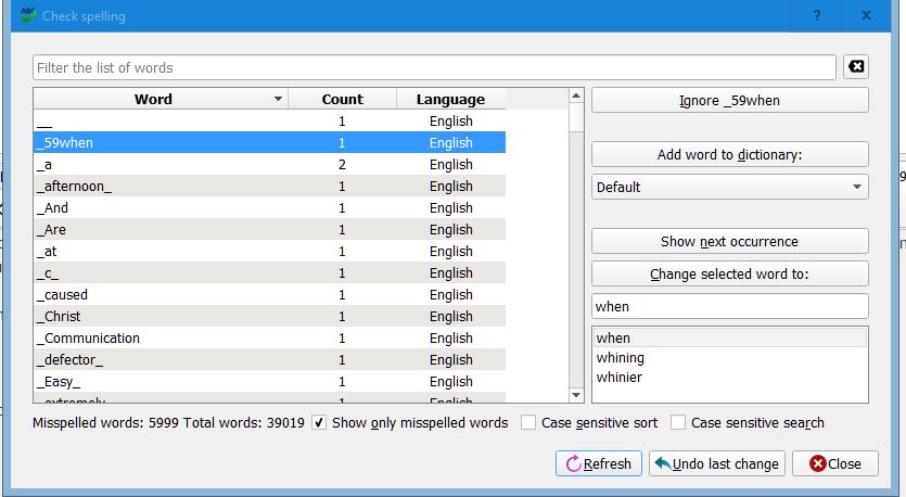

1. With a word selected ('_59when') and (CAPTURE.JPG) just typing a letter ('h') NOT using [Filter], the main word list does not scroll, but the suggestions do (CAPTURE2.JPG) which makes it hard to see what would be changed
Using the [Filter] both windows scroll, so it's a minor inconsistency

1. will be fixed

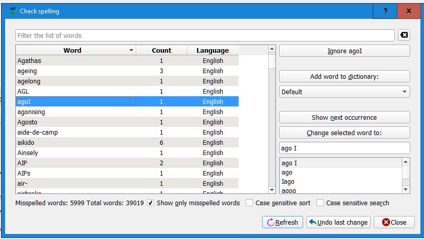

However, the disappearing highlight bar after entering a correction word or picking one from the suggested list really is a real chance for error and extra work
In CAPTURE3.jpg (post #3) an error (agoI) is highlighted (entry N), and the suggested word was taken (ago I) so entry N is deleted from the misspelled words section and the highlight bar disappears
The suggested words section now shows suggestions for what was N-1 (AGL), but AGL is not highlighted (CAPTURE4.jpg)
It would more logical (to me at least) instead of going backwards, that the editor highlight what was N+1 (agonizing) and show it's suggested replacements

Will also be fixed.
