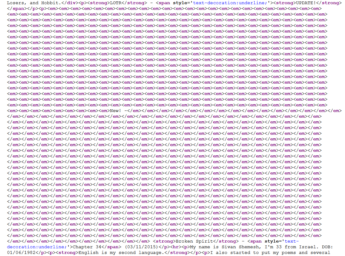

Hi JimmXinu.
Everytime I try to download a story from this author I get the same error, no matter which story it is.
https://www.fanfiction.net/u/439186/SivanShemesh
Here's an example story:
https://www.fanfiction.net/s/2693477/1/
and the error:
Elrond & Estel: Surprise
SivanShemesh
maximum recursion depth exceeded
Old 10-19-2016, 03:40 PM   #1554
JimmXinu
Plugin Developer
JimmXinu's Avatar
Posts: 7,717
Karma: 5010863
Location: Midwest USA
and the error:
SivanShemesh
That author has a couple different blocks of truly excessive numbers of nested <em> tags in their author bio (see attached).
The author page lookup on ffnet is only used to check the author image and skip using it for story covers. You can suppress that by putting skip_author_cover: false under [fanfiction.net]:
[fanfiction.net]
Since this is clearly a one-off, I'm going to suggest using that setting while downloading that author's stories and then change it back afterwards. Or create a temp library, whatever you like.
If you find other authors with similar issues, I'll look into a more general fix.
