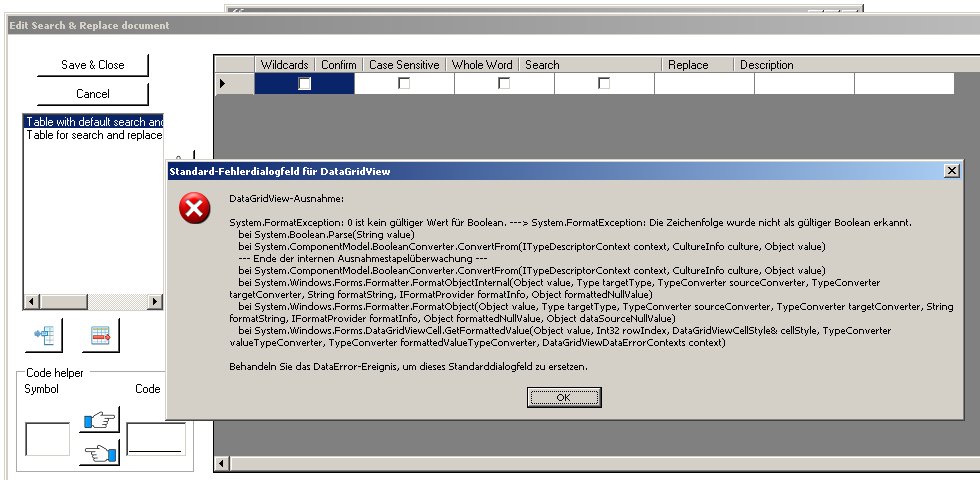

Yes, that is exactly what I did, at first with my modified replacerules.doc(x), then again with the one downloaded from your site.
In both cases I ended up with a XML file with "0" and "1"
it is clear what the problem is, but not how it is caused.
Maybe internal code treats 0 as false and 1 as true?
I took the exception message of the DataGridViewer as hint. (see attachement)
That is exactly what is going on. It will be solved of course!
