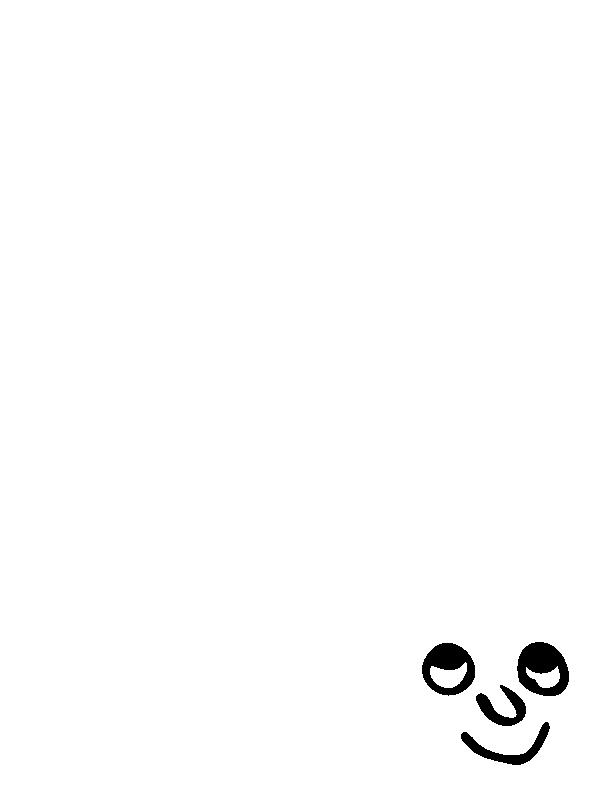

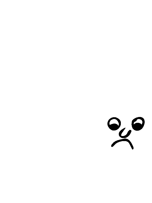

When the reader is connected to the computer, this hack will
- display a happy face if the Kobo umounted the filesystems properly.
- display a sad face if it's still mounted even though it should not be.
If you see a sad face, you might have filesystem corruption and/or still running processes doing the wrong thing.
While the USB is connected it will keep checking state for about 5 minutes, so if some process is slow to free resources you will see a sad face first and it turns into a happy face. (But if the filesystem was mounted/used while it was still a sad face, there might still be corruption).

ID:	151748   Click image for larger version

so it failed to umount, due to process 869 (which blocks /mnt/onboard by using it as a current working directory [cwd] and in the pstree you can see 869 is httpd so the culprit in this case is my webportal mod (which I still have to fix)

When connecting USB while reading KEPUB, nickel still has open file handles to the .kepub file at the time it umounts. It frees them a few seconds later... so this is a "sad face turns into happy face" case.
umount failure /mnt/onboard Wed Aug 12 16:45:10 UTC 2015
/proc/1315/fd/32 2831262 5536 81ed 0 0 b303 73 1 0 0 1439337600 1439394562 1439394563 4096
/proc/1316/fd/32 2831262 5536 81ed 0 0 b303 73 1 0 0 1439337600 1439394562 1439394563 4096
/proc/1337/fd/32 2831262 5536 81ed 0 0 b303 73 1 0 0 1439337600 1439394562 1439394563 4096
/proc/516/fd/32 2831262 5536 81ed 0 0 b303 73 1 0 0 1439337600 1439394562 1439394563 4096
lr-x------    1 root     root            64 Aug 12 16:45 /proc/1315/fd/32 -> /.kobo/kepub/816d01e8-6501-43ec-9985-3dd7bdc7c55b
lr-x------    1 root     root            64 Aug 12 16:45 /proc/1316/fd/32 -> /.kobo/kepub/816d01e8-6501-43ec-9985-3dd7bdc7c55b
lr-x------    1 root     root            64 Aug 12 16:45 /proc/1337/fd/32 -> /.kobo/kepub/816d01e8-6501-43ec-9985-3dd7bdc7c55b
lr-x------    1 root     root            64 Aug 12 16:45 /proc/516/fd/32 -> /.kobo/kepub/816d01e8-6501-43ec-9985-3dd7bdc7c55b

The paths say /.kobo/kepub/thingy because that's what lazy umount does, if it can't umount properly it bends /mnt/onboard/ into a virtual / that is still hooked to the read-write filesystem.
It's probably not a problem in practice, since nickel frees it in the end (and UsbDebug runs quite early, it caught nickel's usb script sleeping so it might be a second before it loaded the storage module.
