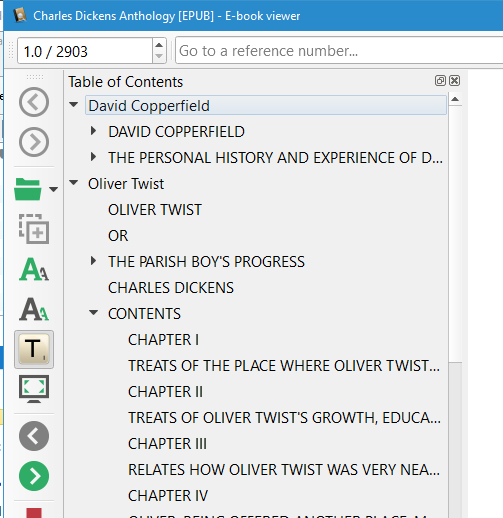

Old 10-01-2016, 09:30 PM   #267
Budfudder
Budfudder began at the beginning.
Posts: 26
Device: Kindle 3
Fantastic tool. But obviously I'm doing something wrong - why is it not generating a TOC for me at all? Each book has their own (they had it when they were single books), but there's no TOC for the anthology as a whole. The only configuration option I can see about it is the checkbox with the text 'Insert Table of Contents entry for each title?' and I have that checked - but still no TOC.
Budfudder is offline   Reply With Quote
Old 10-02-2016, 12:32 AM   #268
JimmXinu
Plugin Developer
JimmXinu's Avatar
Posts: 7,145
Karma: 5005503
Location: Midwest USA
We were having a problem with books with single TOC items, but it was fixed in the last release.
Can you post the epubs (or a couple of them) that have that problem? Or upload them somewhere and PM me the link?
Old 10-02-2016, 08:38 PM   #269
Budfudder
Posts: 26
Device: Kindle 3
Just FYI, I'm using v 2.0.14. I'm getting the problem with ALL books I try to merge, so I don't think it's specific to the books. Is there some step I could be missing or something?
In any case, attached are a couple of the books I've merged and the epub I get when I merge them. Notice that both books have tables of contents, and they are shown in the resulting merged book, but there is no TOC for the anthology itself, showing both books as entries.
File Type: epub David Copperfield - Charles Dickens.epub (871.7 KB, 276 views)
File Type: epub Charles Dickens Anthology - Charles Dickens.epub (1.33 MB, 321 views)
Old 10-02-2016, 08:54 PM   #270
JimmXinu
Plugin Developer
JimmXinu's Avatar
Posts: 7,145
Karma: 5005503
What are you using to read the resulting EPUB that you don't see a TOC?
Because I see exactly the TOC I expected to see in the merged EPUB you posted. I didn't merge them--I just looked inside the EPUBs you posted.
The only thing I can thing of (other than you're using a different reader) is that you mean an in-line TOC in the pages of the EPUB instead of the meta-data TOC...
calibre, combine books, epubmerge, make collection, merge epub, merge epubs
