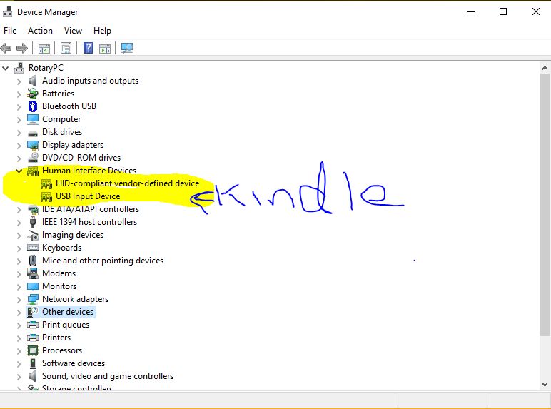

Kindle Touch
Thanks for your reply geekmaster. I have tried three different PC's booting from Kubrick and Windows XP and 10. Also different cables after leaving charge for long periods.
I have a good working of Windows and dos but not Linux. Is there anything else I can do to wake this thing up or check its status? Are we screwed if we cannot get it inti fastboot mode?
Can it be queried from a Linux environment?
Regards from New Zealand
lerl

MfgTool (see my "Select Boot" thread) can replace fastboot mode, but somebody needs to promote an effort to get such features configured for supported Kindles.
