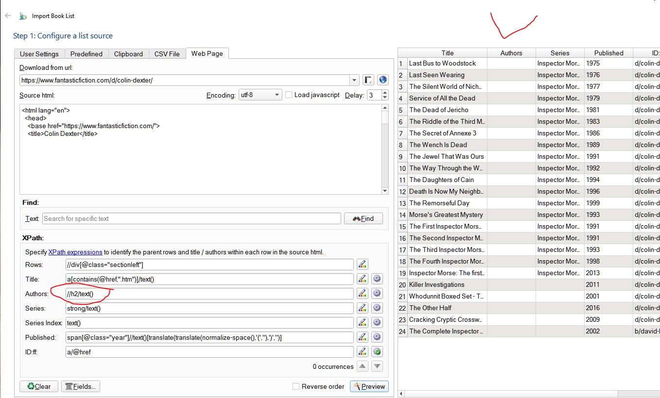

That wasn't hard to fix, just a change from a h2 to h1 for the authors name. But, in my installation the list is just called "Fantastic Fiction". I wasn't expecting it to list the books for one author. The attached file should fix this if you can test it.
I had a quick click through the rest of the predefined lists. Only six or so others don't work. I'll have a better look at these during the week.
I meant
Fantastic Fiction
The Authors field was not getting set when matching Empty books
I had alreadt tweaked my xpath and don't know how to make it forget user changes

The plugin includes predefined imports for some web sites. This is a fix for one of them. If you start the plugin from calibre, on the "User settings" page, there is an "Import" button. Press this, find the file and it will load the new definition as a user list that can then be used in the same way as the predefined ones.

I meant
Fantastic Fiction
Good, because that's what I fixed.
Changing a predefined source isn't saved. Or at least it doesn't seem to be here. I've been saving them, but they appear on the User Settings tab and can be deleted from there. Or have I missed something?

I forgot to restart the first time
Still no joy (see image)
I put title where you had H2 and it worked (my worry, is that was not a proper way )
