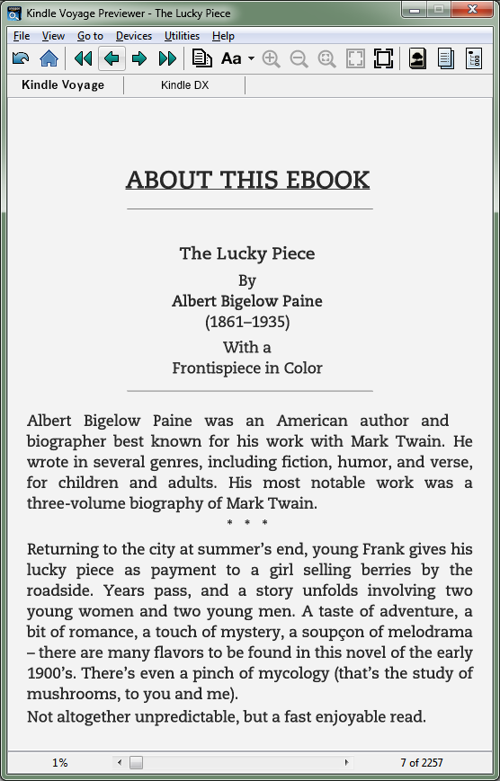

I prefer using Calibre to convert epub to old mobi --- it is MUCH more trustworthy to honor my epub css than Kindlegen, which ignores a lot of things (text-indent: 0; top and bottom margins, and others).
I do see one MINOR problem with the Calibre conversion. Horizontal Rules <hr /> never seem to go the full width of the screen even if I specify width: 100%. It is displaying at about 50 - 60% of the width.
I can put up with it even if there is no workaround for this, but can anyone tell me a trick to make the <hr /> go full width?

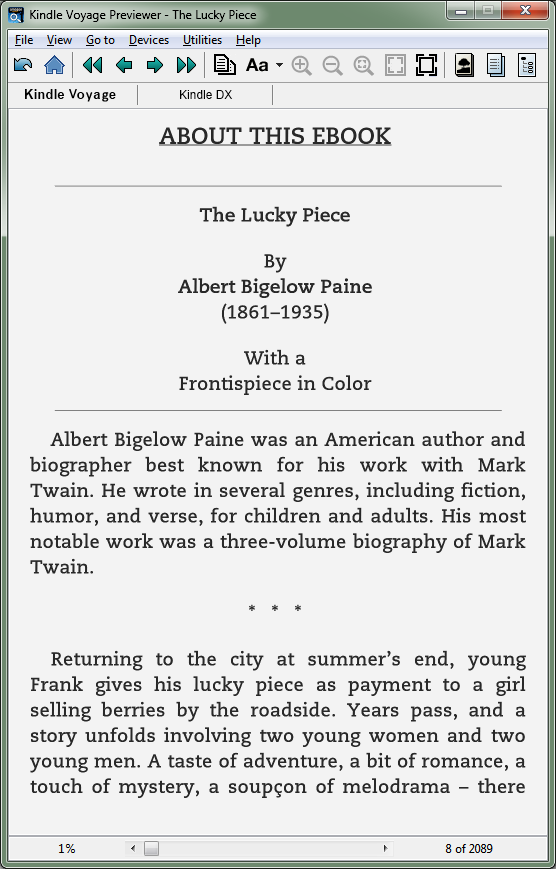

Well, not 100%. Maybe 90 - 95%.
See attached screen-shots for comparison.
As you can also see, kindlegen ignores my text-indent: 0 and my top and bottom margins. That is why I prefer Calibre. But I do wish the hr was wider.
