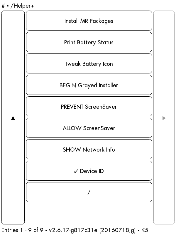

Old 07-17-2016, 09:43 PM   #225
NiLuJe
BLAM!
NiLuJe's Avatar
Posts: 13,506
Karma: 26047202
Location: Paris, France
*rawwrrr*
Which means *possibly* something usable, soon.
Don't mind the K5. Mind the filename and the fullscreen-ness.
