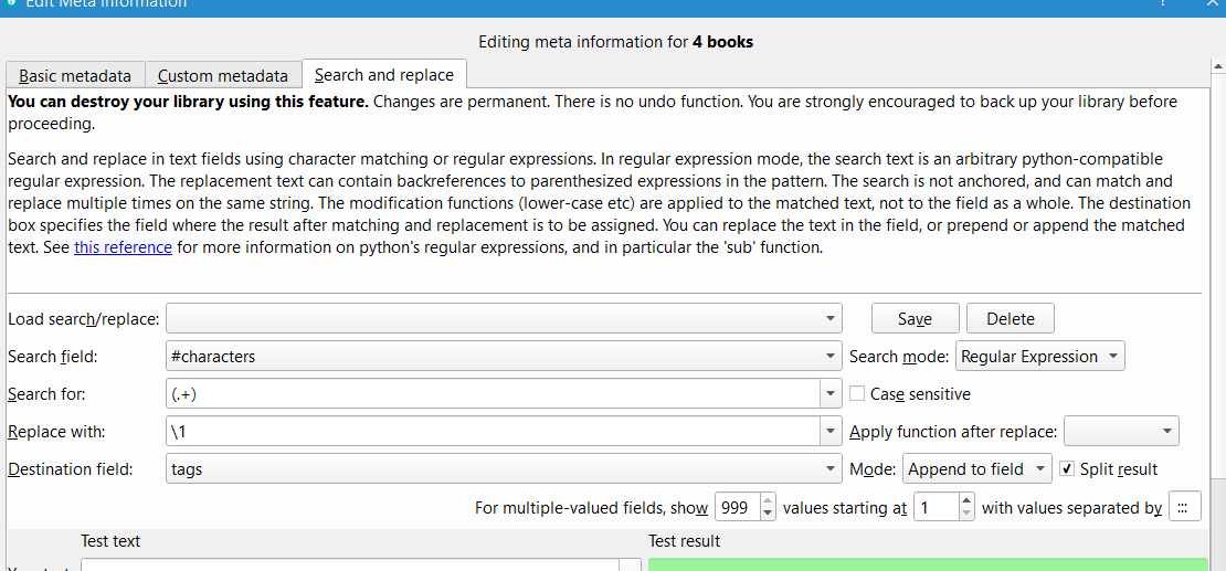

Old 07-14-2016, 03:14 PM   #1378

You'll need to use custom_columns_settings in personal.ini instead of the Custom Columns tab settings and use the 'a' mode.
Thanks!
Is there a possibility to automatically add my manual entries to "characters" in the "tags"column - maybe if I update the story?
ILB is offline   Reply With Quote
Old 07-14-2016, 03:48 PM   #1379
JimmXinu
Plugin Developer
JimmXinu's Avatar
Posts: 7,330
Karma: 5007213
Location: Midwest USA
Originally Posted by ILB View Post
Thanks!
Nothing that comes to mind that FanFicFare can do about that, but you can do it using Calibre's metadata find and replace. See attached.
(No promises that's exactly correct for your purposes, I only thought about it for a few minutes.)

Occasionally, a story thread on SpaceBattles (SB) will link to story posts omakes on SufficientVelocity (SV) or vice versa. When this happens, the omakes in the other forum don't get downloaded, which I find annoying. I can see that, generally speaking, getting FFF to follow every link would be a bad idea, but is it possible to edit my personal.ini so that FFF follows crosslinks to SV from SB and vice versa?
