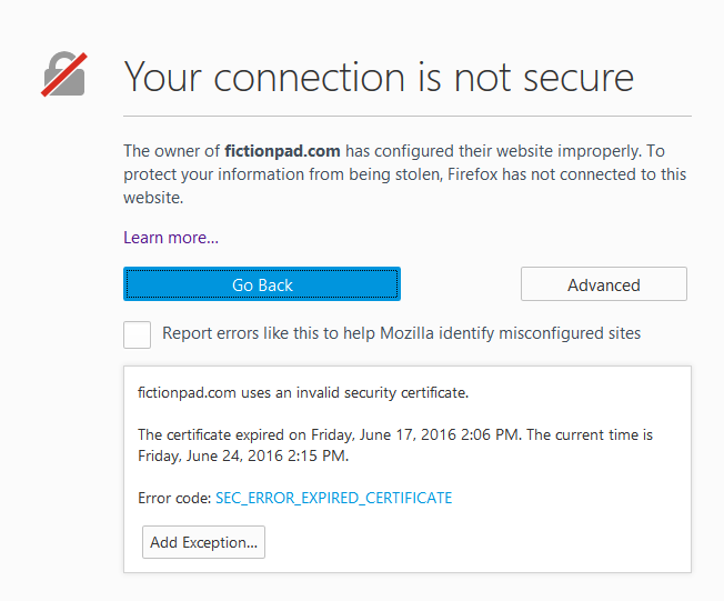

I am currently having a problem downloading from FictionPad with FFF. The error message I am receiving is as follows:
<urlopen error [SSL: CERTIFICATE_VERIFY_FAILED] certificate verify failed (_ssl.c:590)>
I have contacted the admin of that site, however I have not received a response. I was wondering if there is a work-around you might be aware of. I have looked through the preferences, but didn't see any that would allow me to bypass the certificate issue.
Thank you for your time.
fictionpad.com's SSL cert has expired. In fact, it expired a week ago (see attached).
Obviously, the correct solution is for the site to renew their certificate.
By-passing cert verification is theoretically possible, but I don't know how off hand; nor do I particularly want to. If they still haven't fixed it in a couple weeks, ask again.
