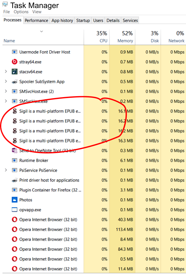

Current status: Sigil will not run. It is installed, but when I click on the icon from the Desktop, it will not start.
Operating System: Windows 10 x64
Here is what happened.
--In April, I updated to 0.9.5 and installed FlightCrew. Sigil updated fine, as usual, and there was no problems. It was working.
--This weekend, I discovered that Sigil would not start, as I was preparing to updated to 0.9.6
I have had successive versions of Sigil on my computer since about 2010, but this is my first time encountering this issue.
I have attached an image of my Windows Task Manager, so you can see it indicates the program is installed and running. But it will not open.
Also, since April, I have no changes to my computer that would affect the operating system.
Thank you very much to whomever can help me with this vexing problem.

Sorry, but I forgot to explain the attached image.
The image shows that each time I click on the Sigil icon from the desktop another instance is created in the Task Manager.
Also, I have installed/uninstalled all of the 0.9 updated, and they will not start either. I even installed/uninstalled back to 0.8.9.
Each time I get a clean uninstall because I use Revo uninstaller software.

I'm guessing a display issue of some kind. No crashes, no errors, and a new instance was being properly launched and reported as running in the task manager--it just wasn't displaying on the screen. That's why I asked about dual displays. It acted exactly as if everything was running correctly, just not on a portion of the screen the user could see.
Doesn't Windows 10 have virtual desktops? Seeing as how the 32-bit version is a different executable in a different location, it wouldn't surprise me that that would "fix" the problem of the 64-bit version being configured to run on a different virtual desktop.
This is all guesswork on my part, of course. I have no idea if virtual desktops would work the way I described. I don't have Windows 10 to experiment with.

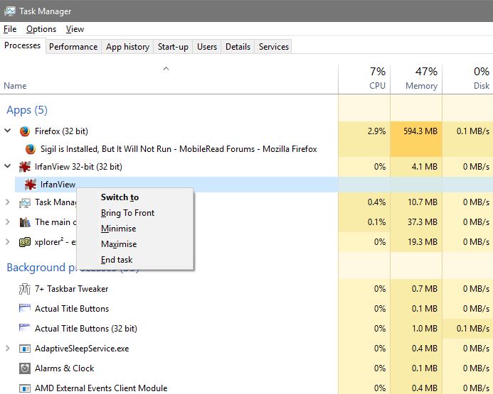

AFAIK a task can only be used from the desktop in which it 'resides', tasks can be moved between desktops via drag and drop.
Task Manager shows all tasks irrespective of which desktop they are on, but without any indication of which desktop they are on You can use the Task Manager context menu to switch to tasks - if they are on another desktop it will 'push' the current desktop aside.
Different desktops cannot have different wallpapers (nor can they be named) There's a gadget at CP that claims it can do it, it's on my list of things to try as its the thing I miss most from my old VD manager.
Added : Oh yes, use Win+Tab to see Desktops, you don't need the Taskview icon cluttering up your taskbar. Also Win+Ctrl+→ and Win+Ctrl+← will traverse VDs.
