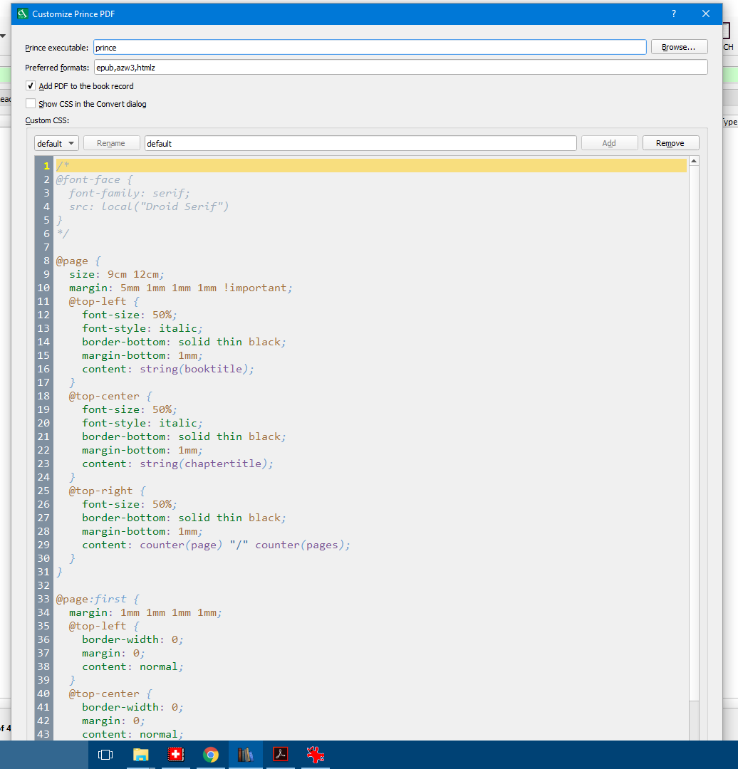

I'm having the following problem: the bottom of the configure dialog is cut off, as can be seen in the attached image.
calibre 2.58 [64bit] on Windows 10 Pro
Name:	Prince PDF configure dialog.png

@readin:
Most Calibre customization dialogs are resizable to some degree via the mouse. Drag a top corner down, reposition it, then resize and reposition repeatedly as needed.
You can then use the scroll-bar to see what is otherwise not visible.
DaltonST

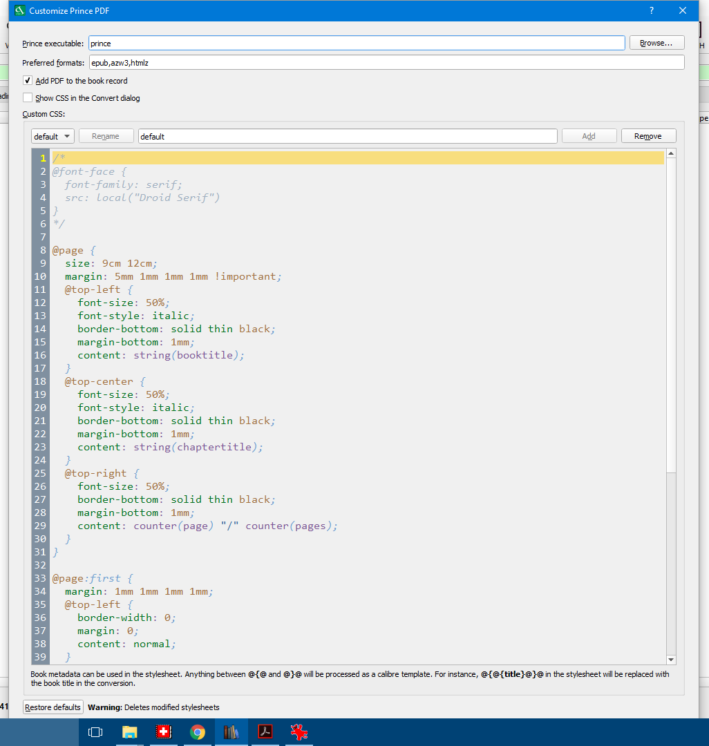

The first attached screenshot shows what the dialog looks like after I try to drag the top border down -- it won't drag down more than a tiny amount.
If I attempt to move the dialog around, I can sometimes get the dialog to look like in the second screenshot, with part but not all of the bottom panel showing.
Also, as can be seen in the second screenshot, the scrollbar is only for the CSS stylesheet in the middle panel, and doesn't scroll to the bottom of the dialog.
Name:	Prince PDF configure dialog after dragging top border down.png
ID:	149408   Click image for larger version
Name:	Prince PDF configure dialog after moving window.png

In case it helps, I discovered that changing my Windows settings to auto-hide the Taskbar allows the entire dialog to show, as in the attached screenshot.
Name:	Prince PDF after hiding Taskbar.png
