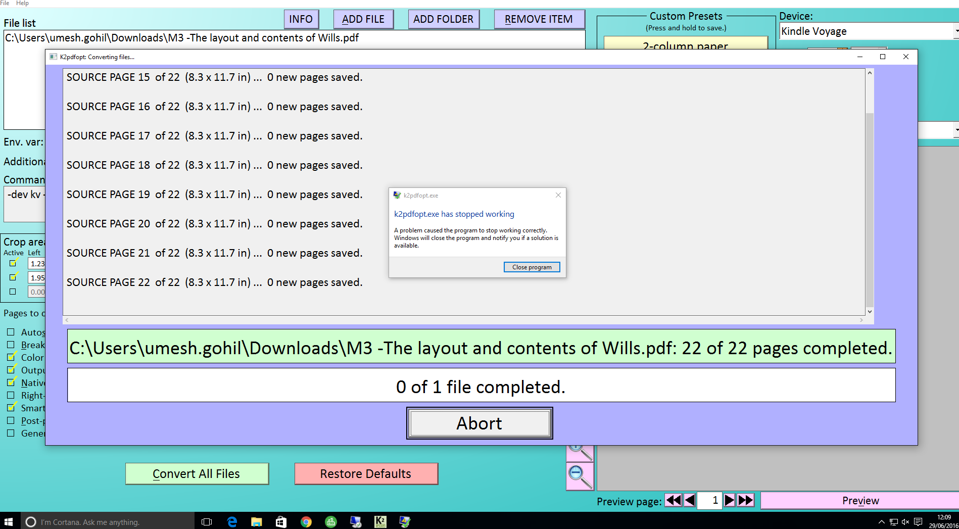

I am using Windows 10 and I have tried all 64 Bit version but I am getting the error message when I select the ' convert' option
Can someone please assist
Thank you
Thank you
Can you post a screen shot of your GUI before you start the conversion? It's a long shot, but are you certain that (1) you have enough disk space for the conversion, and (2) you are saving into a folder where you have write permissions?
