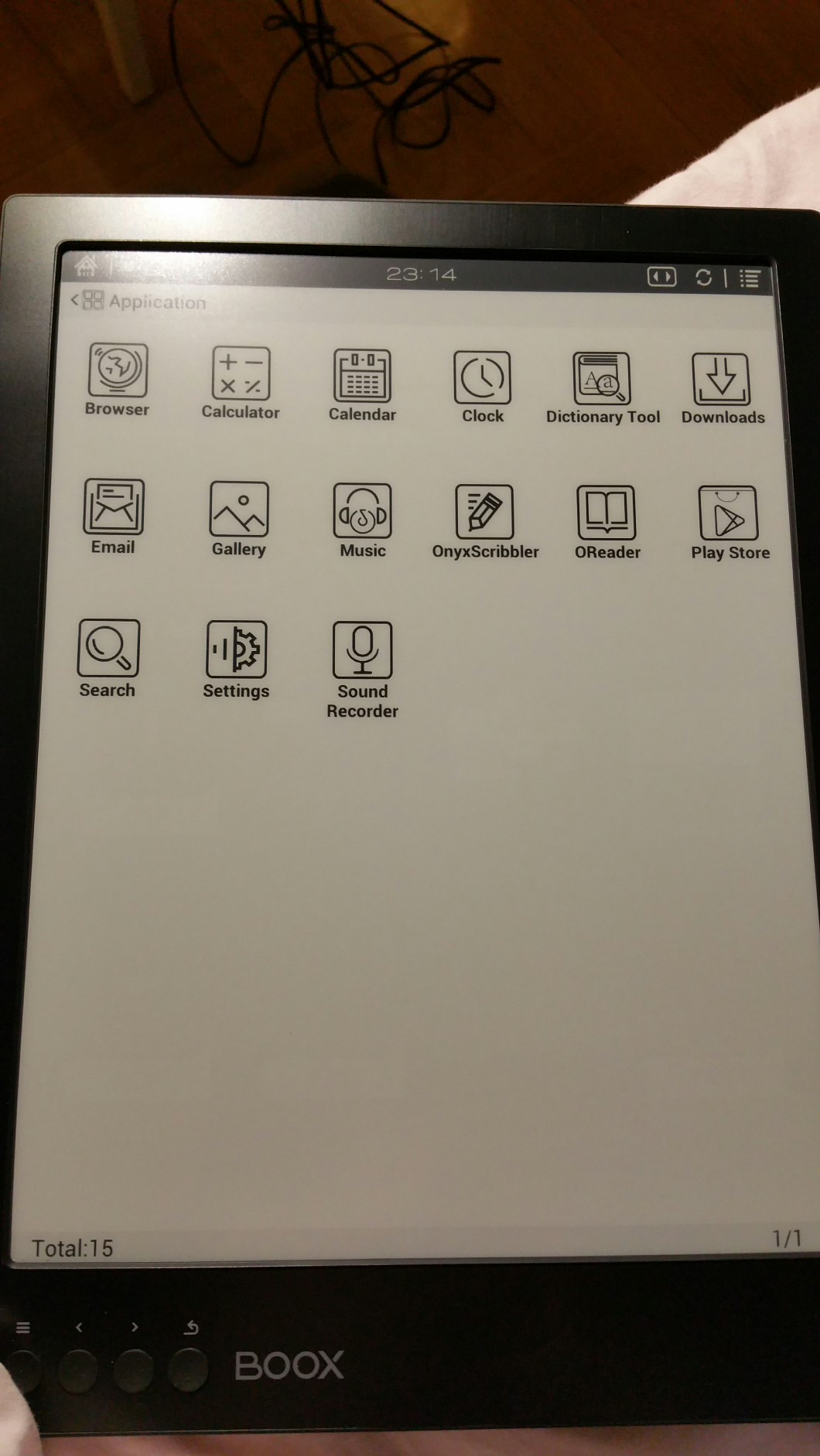

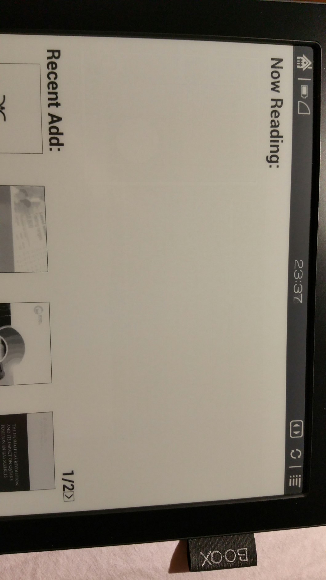

I got my Max yesterday pm. I am now playing with it and I'm bit dissapointed with the quality of the screen.
It's my first eink device and I have never seen one before, not even a Kindle...
Thing is there is significant ghosting, i am reading a pdf through the onyx app and i can see still fadded the "loading document" icon in the background, like a watermark.
Or if i change menu from "now reading" to "library", i can see still as watermark the previous menu...
There is also a distinct black line like an ecliptic on the top part of the screen...
Are all these normal for an eink device??
I paid 700 euros to have something crystal clear and sadly it doesnt seem to be the case.
Added some pics, where you can see the blotches in the white areas.

Ghosting is normal for E-Ink if you are only doing the faster redraws on each page. If you want to remove the ghosting, you have to enable the full refresh every time you change the screen. That's slower and there's more flashing going on (to wipe out the ghosting), so it's usually not enabled by default.

I would like to see your reaction when you enable the "Performance First" option then (the arrows pointing clockwise icon in the top right corner)
Back to the ghosting issue, as rkomar said it's normal. The M96 model does not offer system wide option for setting full refresh AFAIK, instead you have to long press the Home button every time you want the ghosting to go away. Or, if you are using Onyx Neo Reader, open the Settings by pressing the Home button once and look for Refresh setting where you can set it to Always.
To make sure you are using Onyx Neo Reader long press on some book on the Home screen to get the Open with dialog.
My wild guess is it works in a similar way on your Max.

As already mentioned enable the one-page refresh rate and don't use th A2 mode. The Kindle has ghosting too if you disable the one-page refresh rate.

Rkomar has right,all E-ink devices have a ghosting effect. Some people prefer a light ghosting effect than a full refresh of the page. Normally, you could select at what frequency the refresh is done : every page, 1/3, 1.5, etc. But don't be afraid of the ghosting effect, with the time it will not be a problem for you. The advantages of E-ink are more important and with some texts, you'll forget it.
In your case it's only more evident, because you pass from a display (menu) to an other very different.

Guys thank you all for the help, applying the refresh per every page makes a difference!
Would this lower the life expectancy of the reader?
I can still see a thin pencil line on the screen, like someone drew it with a compass, not that it matters but just wondering why its there.
Thanks again.

Don't worry about the life of the reader. The only true consequence is to consume more battery.
