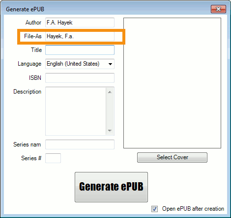

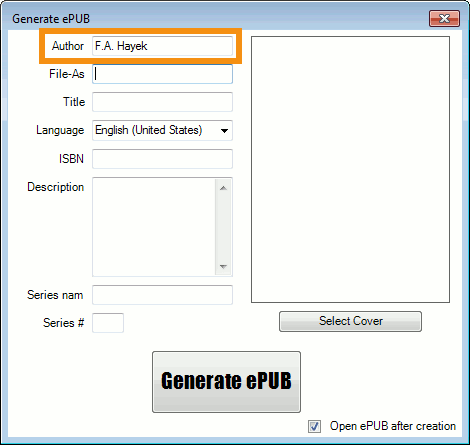

Bug with the new "File-As" Box
Steps to Reproduce
In the "Generate ePUB" dialog box, type "F.A. Hayek" into the Author field.
click into another box.
File-As automatically shows "Hayek, F.a.":
If you type "F. A. Hayek" into the Author field, the File-As turns out as intended ("Hayek, F. A.").
Expected Functionality
Author: "F.A. Hayek" -> File-As: "Hayek, F.A."

I don't know if I can count that as a real bug to be honest. The file-as tries to guess the structure of the name and usually does it pretty well. That being said, the example in your case should be fine. I will take a look at it.
Good thing I didn't make the file-as field read-only, right?

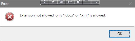

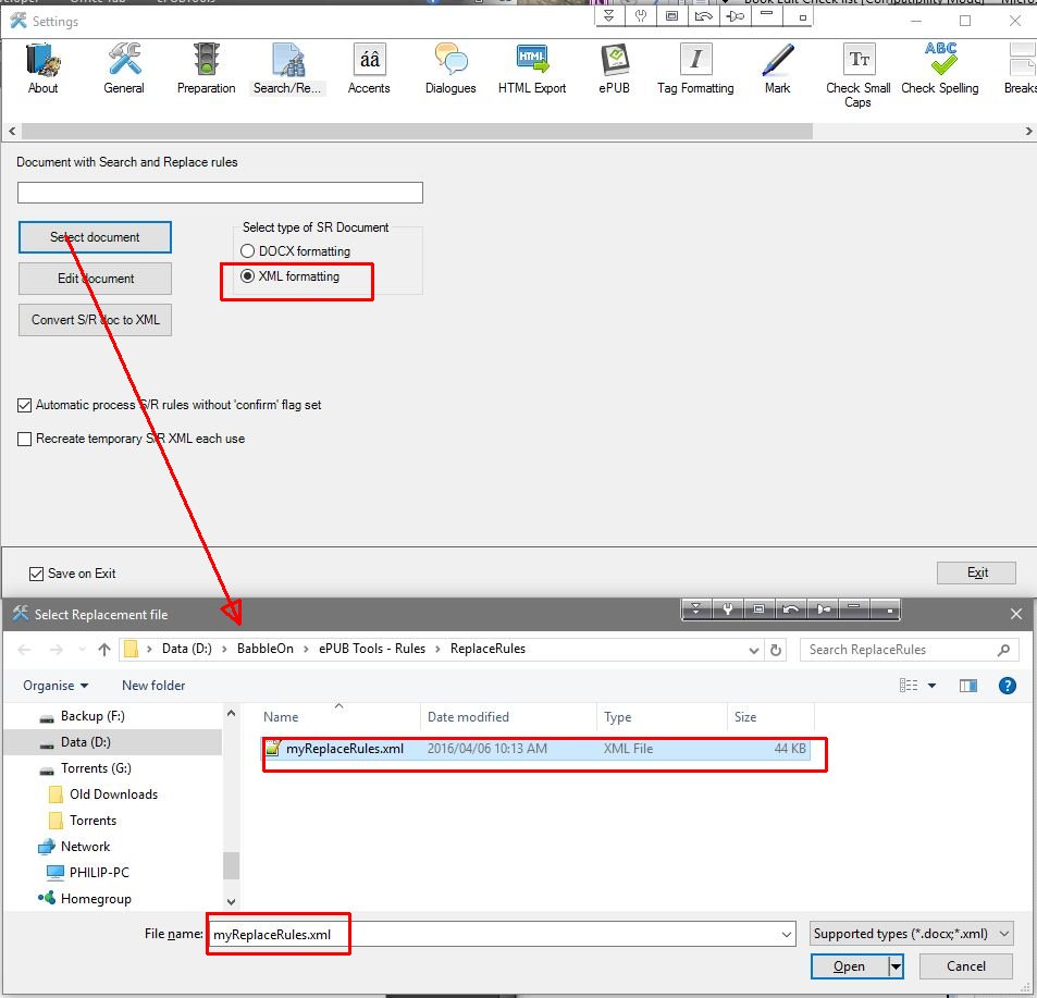

Sorry another bug - I cant Select my XML S&R Rules file, when I do this:
I get this
Happens with 1.23.1 and 1.23, I don't want to go back to 1.22 because then I would lose the changes you made to dialogue checker. I have been using that file for months. I downloaded the sample XML from toxaris.nl/en and got the same result
Can you tell me what I need to hand code into the epubtools.cfg file so that I can use 'myreplacerules.xml' file Ψ²
Attachment 149205
I get this
Attachment 149206
I will fix this of course, this is silly. I typed OR instead of AND.
What you must change in the configuration file specify the correct path in the parameter "locVervang" while Word is not running. When you start Word, that file should be used.

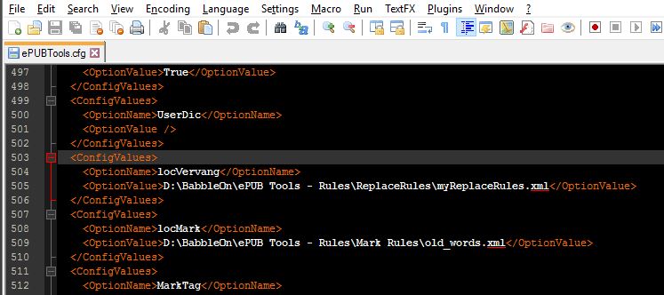

Didn't work - same result as yesterday - are you sure the tag name is right?
the Select file for Mark Rules works OK - here's what I entered
Solved - I added a new locVervang, after the existing empty one I wasn't sure if I needed to wrap the path in quotes, so I used the Mark option as a guide, hence the adjacency.
After I deleted the empty one its OK
