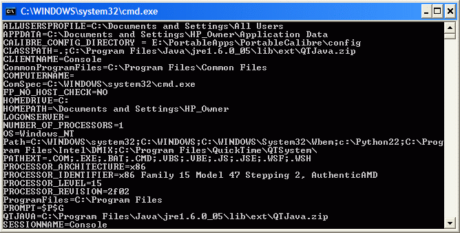

That's just it. No matter what I try, Calibre still uses %appdata% and ignores the value of the CALIBRE_CONFIG_DIRECTORY environment variable. It doesn't matter if %appdata%\calibre already exists or not. Calibre still uses it.

Its not picking up the environment variable in that case. What does the following print out
calibre-debug -c "import os; print os.environ['CALIBRE_CONFIG_DIRECTORY']"

  File "debug.py", line 105, in <module>
  File "debug.py", line 89, in main
  File "<string>", line 1, in <module>
  File "os.pyo", line 423, in __getitem__
KeyError: 'CALIBRE_CONFIG_DIRECTORY'
Thank you very much for the extremely quick replies.
Additional info:
This was using Calibre 0.4.128.

That means the variable is not present in the process environment. Try rebooting.

You only need to reboot if you're adding the environment variable via the control panel. You probably just have to modify your bat file to get it to correctly set the environment variable. Again some one familiar with bat files will have to help you with that

Thanks for the tip. Finally figured out my mistake.
I was using:
set CALIBRE_CONFIG_DIRECTORY = %CD%
instead of:
set CALIBRE_CONFIG_DIRECTORY=%CD%
Yep, stupid spaces got me.
Tested the fixed batch file on three systems (two PCs w/o Calibre and one VM with Calibre already installed). It seems to work quite well. It didn't overwrite the config files in the native installation of Calibre which is a good thing. Oh well, I'm just happy it doesn't leave any traces in the host computer.
