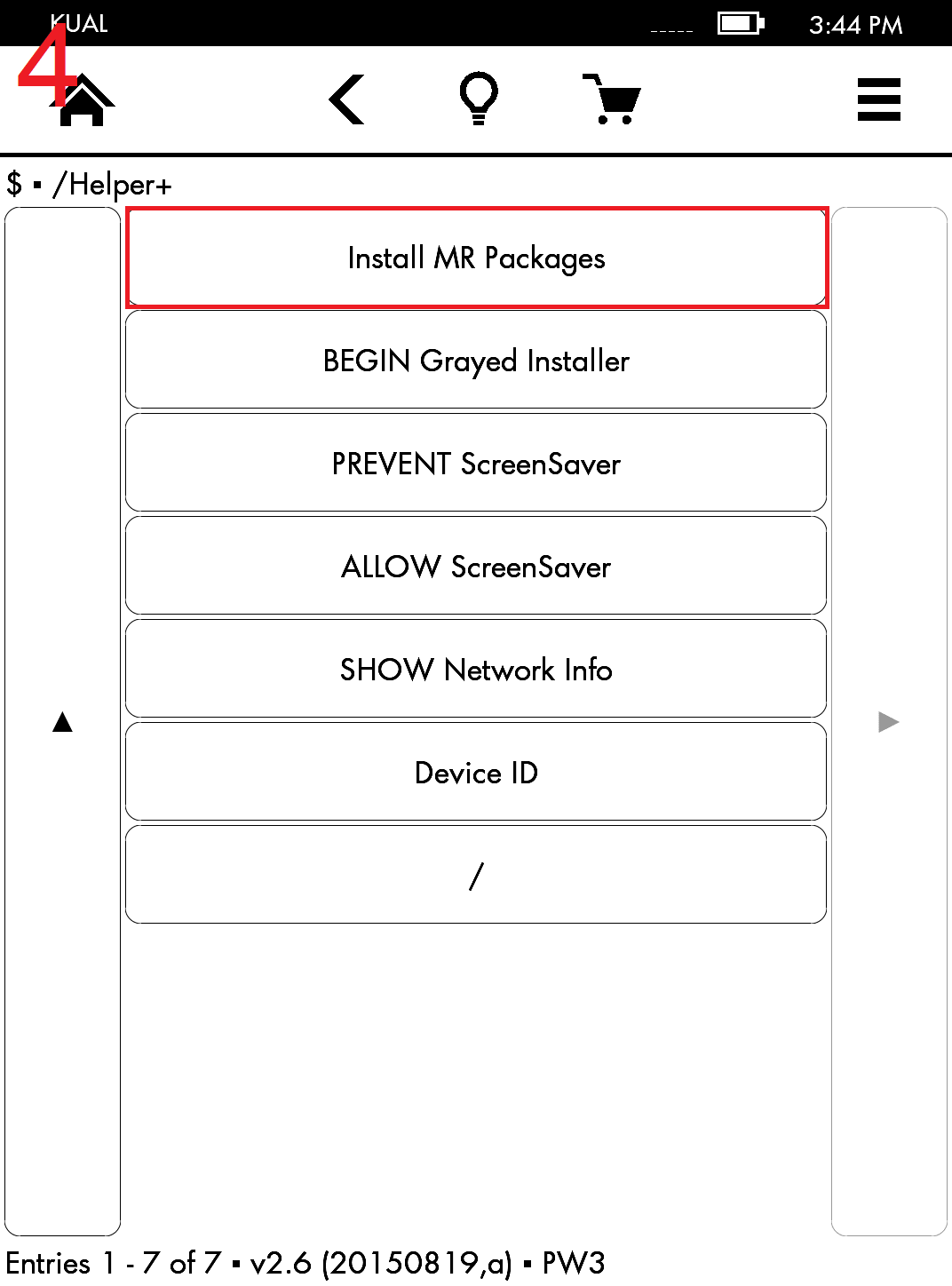

The Specifics
A--->Z
ID:	148976   Click image for larger version
ID:	148977   Click image for larger version
ID:	148978   Click image for larger version
ID:	148979   Click image for larger version
ID:	148980   Click image for larger version
ID:	148983   Click image for larger version
ID:	148984   Click image for larger version
ID:	148985   Click image for larger version
ID:	148986   Click image for larger version
ID:	148987   Click image for larger version

@K+kue:
First, your timestamps are hella screwy.
And second, as mentioned, those packages are not targeting your device/FW, hence them being discarded by MRPI.
Check the MRPI log (extensions/mrinstaller/log/mrinstaller.log or somewhere around there) to confirm that.
