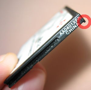

Update (and for googlers): My 4GB Kingston Elite Pro card arrived today. It works fine now (factory-formatted), but the card itself's got a little plastic edge which makes it necessary to use a bit of force to seat it properly.
I whittled this edge off with a sharp knife, now it slides in easily.
It had me stumped for a while though, as I thought the card was broken when it just wasn't fully inserted

Are you referring to the little edge that I marked in the attached picture? These should be standard-compliant. All my CF cards have this edge, and they all fit wonderfully into my device.

Yes, that's the one. In my device it got caught on the lower edge of the slot when the card lacked about 2mm from being fully inserted. I had to bend the card to insert it, so I whittled the edge away instead. I've never had a CF card, so I thought my card was peculiar.
It works fine now, so I'm happy
