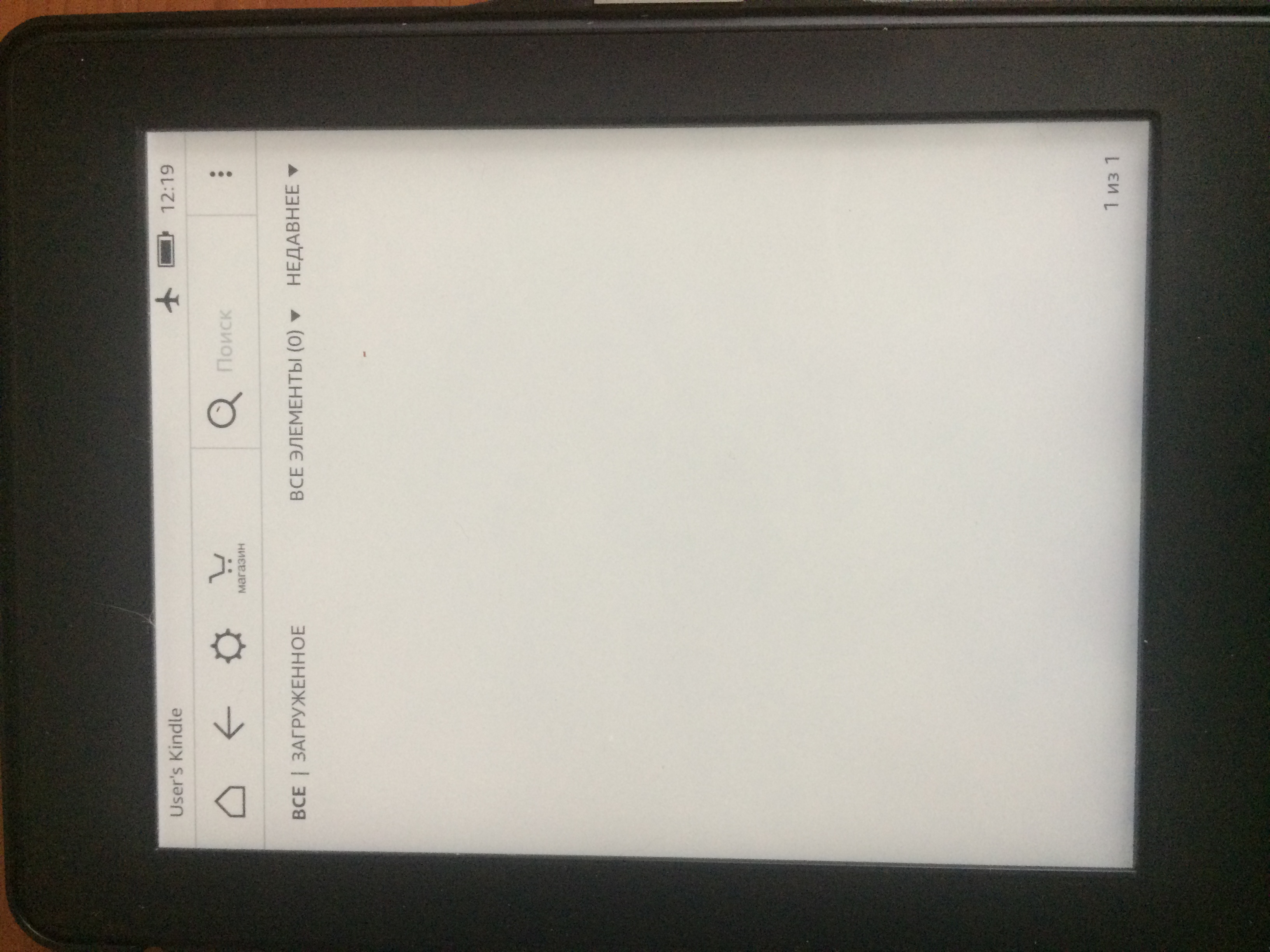

After restart all gone again, it's empty (see photo). Maybe i don't say something important, please ask.
About pont 3-5:
3. Pw3 5.7.3.1 with jb goes to internet
4.after that kindle empty (no books, see photo)
5. I do jb again, and now i see books but kindle launcher isn't work

Нажмите "Загруженное".

Stop trying to install the JB it (Branch Delay's jailbreak, as opposed to the hotfix) doesn't work on firmware 5.7.3 anyway.
Switch from "All" to "Downloaded", that would be "BCE" to "Загруженное" I think.
You are currently viewing the (purchased) books in your Amazon Cloud.

Спасибо огромное! Все заработало!

Thanks! all works!!!
