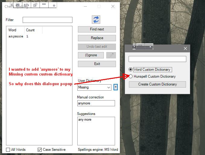

Adding words to the dictionary can only done by right-clicking on the word. The + sign is for creating a new custom dictionary (as indicated in the manual...). However, I do see that this might not be to intuitive.
You can use the same dictionaries that you use for Sigil. At the moment however they need to be in %appdata%\Toxaris\Lang. That is also mentioned in the manual. As the list of languages is automatically determined, I am not sure I will change that shortly.

I do recall you saying that you would have a feature to add new custom dictionaries from the spellchecker - at the time I thought 'that's a bit extravagant'
Could the Add word to (custom) dictionary context menu option offer the list of configured custom dictionaries
Hmmm - I'll put symlinks in %Appdata%\Toxaris\Lang referencing %ProgramFiles%\Sigil\hunspell_dictionaries items - they'll break when I install a new version of Sigil but I have a symlink repair tool.
The creation of new custom dictionaries should now be done in the settings, where it should... The word will be added to the current selected custom dictionary. At the moment (at least) there will not be an option to choose the custom dictionary directly with the add action.

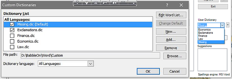

@Toxaris - spell checker appears to include all custom dictionaries - rather than only those checked off in Options->Proofing.
Can you confirm that, and can it be 'fixed'.

No, with the Hunspell engine only the one selected will be used. You can select another of course, but only one can be used.
Now, for the Word spelling engine it is a little different. In the Word options you can select more than one custom dictionary to be active at the same time. Those will be active, combined with the one selected in form.

In the screen shot I posted you'll see I am using the Word Engine.
I intend retaining Word's dictionary (engine) as my primary spell checker source, the hunspell dictionaries will remain as a secondary option. So I'm currently focusing my attention on the Word Engine option.
In Word Options->Proofing>Custom dictionaries my Finance, Economics and Law custom dictionaries are unchecked, so I was surprised to see them in the Custom dictionary drop down. Are they being be used in the checking process - it doesn't appear so (nor should they be), can you confirm that?
If/when you provide an 'Add word to dictionary' I definitely don't want the ability to add a word to an 'unchecked' dictionary - e.g. to my Finance dictionary when I'm spell checking Swift's 'A Modest Proposal'

All custom dictionaries are identified and placed in the dropdown. However, only the one actually selected should be used. Now, if there are multiple custom dictionaries in the Word settings are selected, I *think* they will be used as well. It depends on how the function is programmed. I will look into a possibilities to find all the selected custom dictionaries, unselect them and at exit of the spelling procedure restore old setting.
If you choose 'add to dictionary', it will add to the selected custom dictionary in the dropbox, so the one you see.

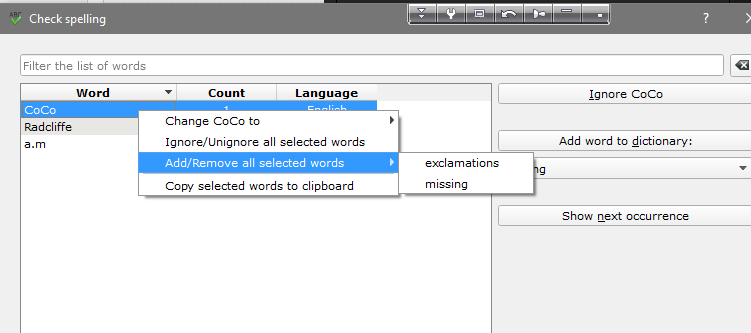

As far as I can tell from observation (using the Word Engine), only the selected (active) dictionaries in Word->Options->Proofing->Custom Dictionaries are being used in the actual spell checking process, which is consistent with Word's built in spell checker. Are you able to confirm this from a developers perspective?
However, in a nutshell my main concern is this:
In your implementation of the "Add Word to dictionary" feature, I would only want to see dictionaries listed that I have activated in Word->Options->Proofing->Custom Dictionaries.
IMO the best-of-breed implementation of this particular function, from a UI perspective, is the spellchecker in the calibre editor - in that it only offers 'active' custom dictionaries in it's "Add Word to dictionary" option :
Which custom dictionaries are 'active' is defined in the Calibre Editor's Preferences, much like they are in Words Options->Proofing

No, the selected custom dictionary is used, both for Word and Hunspell. They do not have to be added to Word itself. In fact, I programmed it like that on purpose. I don't want to force user dictionaries to be added to Word if you only want to use them for Hunspell for example. If you want, you can add them to Word easily via the button in the settings.
The 'Add to Dictionary' will add the word only to the selected user dictionary in the dropdown box. As this is also the used user dictionary, this avoids confusion and makes the most sense as this is the custom dictionary actually used.
I do not know what the checkbox does in the Word settings for custom dictionaries, although I can guess of course. As far as I know I cannot influence that with programming nor check if a custom dictionary is checked there. There is no property to check that. I have looked into the documentation, but so far found nothing. When I retrieve the list of active custom dictionaries from Word, I get them all, checked and unchecked.
Even worse, if you add words to a custom dictionary in Word, you need to restart Word before it gets active for Word itself. Since my spelling procedure works differently, that is no need for a restart.
