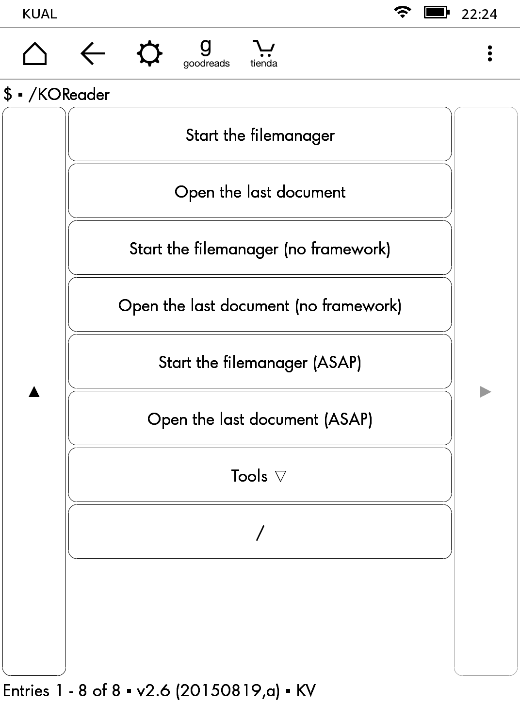

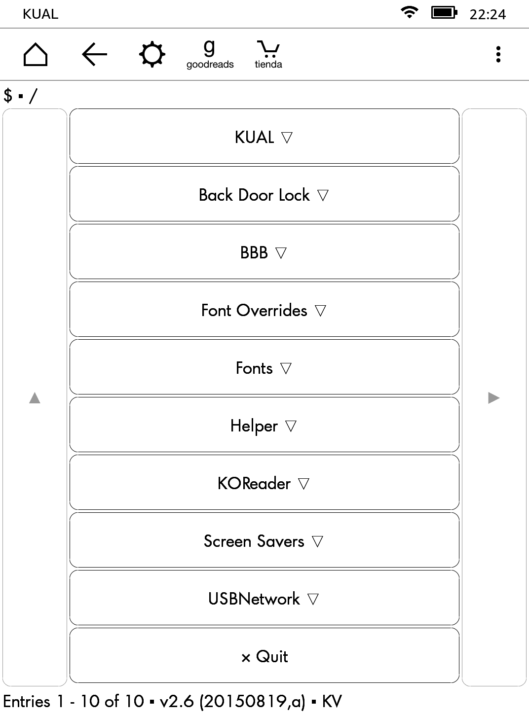

Old 02-25-2016, 09:35 PM   #915
el_topo50
el_topo50 ought to be getting tired of karma fortunes by now.el_topo50 ought to be getting tired of karma fortunes by now.el_topo50 ought to be getting tired of karma fortunes by now.el_topo50 ought to be getting tired of karma fortunes by now.el_topo50 ought to be getting tired of karma fortunes by now.el_topo50 ought to be getting tired of karma fortunes by now.el_topo50 ought to be getting tired of karma fortunes by now.el_topo50 ought to be getting tired of karma fortunes by now.el_topo50 ought to be getting tired of karma fortunes by now.el_topo50 ought to be getting tired of karma fortunes by now.el_topo50 ought to be getting tired of karma fortunes by now.
el_topo50's Avatar
Posts: 52
Karma: 647162
Join Date: Oct 2013
Device: Kindle Voyage (5.7.2.1. JB)
Originally Posted by CalbertAmu View Post
I am jailbroken and loving the screensaver hack. I am gonna try this again, thank you!
Yes, the screensaver hack is GREAT!!! If it helps, i launch koreader via kual 2.6.
Here are some screenshots...
