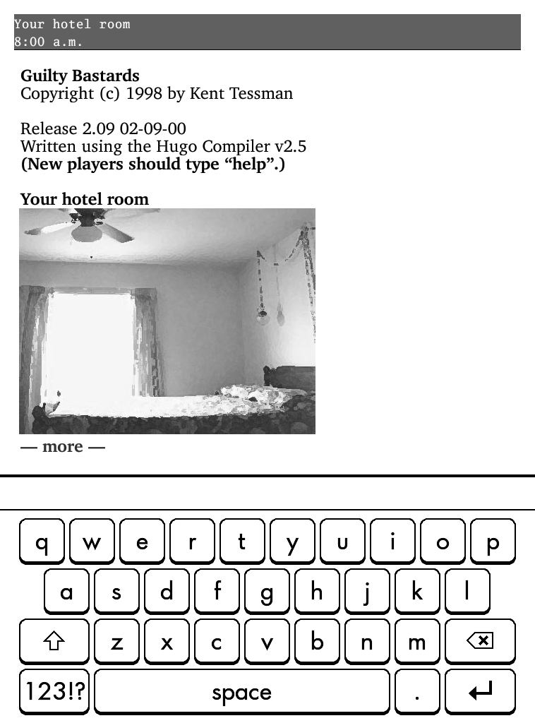

No updates for different game file types in a long while..
So, here goes.. The Hugo interactive fiction design system: http://www.generalcoffee.com/old/hugo.html
Sample game: "Guilty Bastards"..: http://www.ifarchive.org/if-archive/...ugo/guilty.zip
Copy the "guilty.hex" and "GBDATA" files from the zip to the kindle..
Screenshot attached..
