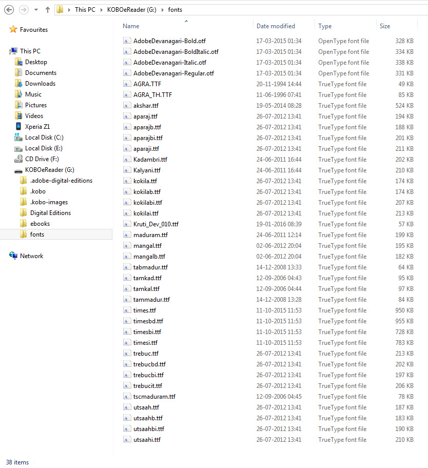

@tshering - Please check the attached image. It has all the fonts that i have installed on my device. Kindly suggest some good and appropriate fonts if you think the ones i have installed are not correct.
@meeera - Hey...yes i did follow the same procedure what you are suggesting here but no luck.

I think that no source has the correct filename. Must be:
fontname.ttf (for regular font)
fontname-Italic.ttf
fontname-Bold.ttf
fontname-BoldItalic.ttf
Rename fonts and reset

@xcuseme_1978
Do you see any of these many fonts listed, when you open the font settings? To access the font settings, you touch the bottom of the screen when a book is opened. Then you touch the symbol "Aa". In the dialogue field that will open, you can select from the available fonts ("Font Face"). Or did you already select one of your Hindi fonts and the book did nevertheless not show Hindi characters? I am asking just in case you did not see my question 1).
When you see some of the Hindi fonts in the list of the font settings, they should work, even if italics and bold will not be used because of the specific font naming requirements of the reading software. Therefore, if you see any of the the fonts in the list, and after selecting it, no Hindi characters show, we would have to think about how your epubs are coded.

Mate i have done the font checking and some of the fonts are showing up in the list and when i have select them the epub font does change but does not think that they are the default or right fonts because the characters jumble up. So i'm wondering how can i read the hindi epubs on my kobo when i don't know what font epubs are using.
@surquizu
I know kobo supports .ttf and .otf fonts. But didn't know that naming convention also matters. Will surely try whatever you have suggested. Thanks for your suggestions and guidance.

Not quite right. If you are using Windows, view the font via the font viewer and look at what comes up for the line that reads Font name: Once you see the font name, use that.
For my modified Charis SIL, the font name is Charis SIL Modified. So the font filenames would be...
Charis SIL Compact-Regular.ttf
Charis SIL Compact-Italic.ttf
Charis SIL Compact-Bold.ttf
Charis SIL Compact-BoldItalic.ttf
You have to know the internal font name in order to be able to correctly name the files.
I think( I'm not sure) that you should rename the font: internal font name without spaces. I also believe that the font regular should not include the "regular" word in the name.
If the internal font name has spaces then the file name also should have spaces. And as for the regular font, I did name it properly. It's how I have it named on my H2O and it works perfectly.
If your internal font name is Charis SIL Modified why are you using external filenames beginning Charis SIL Compact- ...?
That doesn't follow the Kobo font naming rules as I understand them. Shouldn't they match each other?
