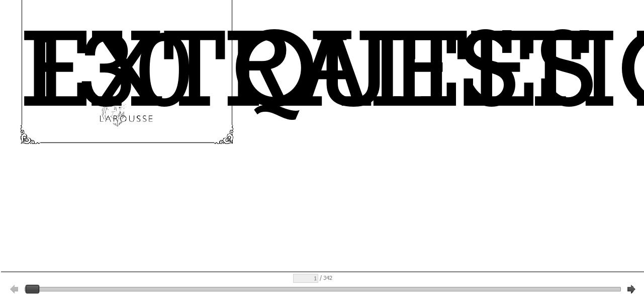

pls in ebook epub when i try to read it it not display in the good way

Originally Posted by doubleshuffle View Post
Hi akhilis!
Perhaps you should ask in the epub forum and add a bit of information, for instance: Is it only one specific epub or all of them? Which reader do you use? etc.
But is the problem format EPUB??
What I see is Overlapped letters or next LINES.
Without an original, I can't tell.
In a HTML based document it might be a negative top Margin or a really small line-height
If it was a PDF original... All bets are off (see the PDF conversion sticky in Calibre Conversions). That is obviously a display font-face. It could be images of letters that get mixed in where they decode upon converting

This could be caused by any of the following:
1. A bug in which older versions of iBooks barf on SVG <text> elements that contain multiple <tspan> elements.
2. A font whose metrics are incorrect, resulting in a zero computed line height.
3. Incorrect CSS that specifies a zero line height.
Or it could probably be caused by any number of other things. It would help to know:
1. The reader you're using (and possibly the version)
2. A trimmed-down snippet of HTML and CSS that reproduces the problem

hello i am using adobe digital editions 3.0
Her is a copy you so you can see the problem [link deleted]
