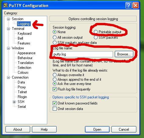

Enable the capture file (Session Logging) in Putty.
Re-boot the Kindle.
This way we can see everything that happens on the serial port.
What (if anything) you enter using the screen -
Anything you do on another computer -
Keep notes.
When you hit a point that you can not go futher -
Disable the capture file -
Open the log file in a text editor, annotate the log at the proper points with your notes.
When you use a file (or anything else) that you got somewhere else, include a link and a name.
Compress the capture file (log file).
Please do not use RAR (it still has not gone fully Open Source) -
Use 7Zip instead (which you need for opening NiLuJe's snapshots anyway) -
http://www.7-zip.org/download.html
Attach the compressed capture file (log file) to your next post.
You will have to select the 'Advanced Editor' and scroll down past the text entry box to see the 'Manage Attachments' section.
**Remember when Posting**
  • We can not see over your shoulder.
  • We can not directly channel into your mind.
You must write up everything you do.
Use your native language if you must, somebody here can translate it.
The site has over 1/4 million members, so unless you are the Last of the Monhicans, somebody can read it.
This post might help:
http://www.garynorth.com/public/1896.cfm
