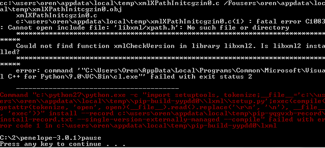

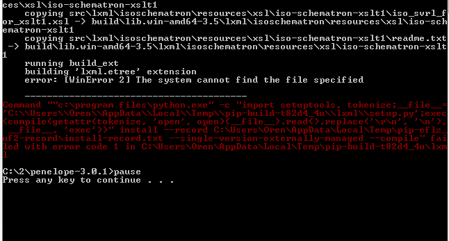

Hi Alberto
I try to install with Win7 but get an error, this is what i did:
1) extract the file
2)copy pip-Win_1.7, to the folder.
3)run the command "pip install penelope" and run.
4)get an error "error:microsoft visual c++ 9.0 is required".
5)download and install microsoft visual c++ 9.0.
6)run and get an error see pic1-(Python 2.7)
7)download Python 3.5 get error pic2
ID:	144067   Click image for larger version
oren64 is offline   Reply With Quote
Old 11-25-2015, 10:40 AM   #150
AlPe
Digital Amanuensis
AlPe ought to be getting tired of karma fortunes by now.AlPe ought to be getting tired of karma fortunes by now.AlPe ought to be getting tired of karma fortunes by now.AlPe ought to be getting tired of karma fortunes by now.AlPe ought to be getting tired of karma fortunes by now.AlPe ought to be getting tired of karma fortunes by now.AlPe ought to be getting tired of karma fortunes by now.AlPe ought to be getting tired of karma fortunes by now.AlPe ought to be getting tired of karma fortunes by now.AlPe ought to be getting tired of karma fortunes by now.AlPe ought to be getting tired of karma fortunes by now.
AlPe's Avatar
Posts: 727
Karma: 1446357
Location: Turin, Italy
Device: Several eReaders and tablets
EDIT: I did not read the screenshots carefully enough. It looks you have the compiler installed, but compiling lxml fails for some reason.
It seems a very recent problem, see if these posts on StackOverflow help you:
http://stackoverflow.com/questions/3...scrapy-install
or
http://stackoverflow.com/questions/3...85756#33785756
Once you have lxml installed, try pip install penelope again.
Alternatively, you can get Penelope by source: https://github.com/pettarin/penelope#from-source-code If you do not read/write XML files, not having lxml should not prevent Penelope from running. (You might need to pip install marisa-trie separately, if you read/write in Kobo format)
