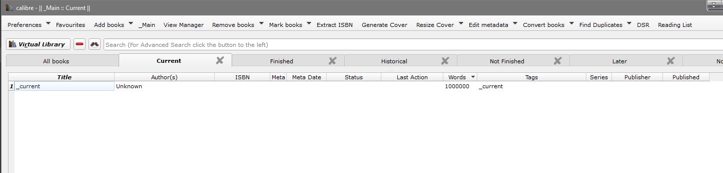

Well maybe that's what supposed to happen theoretically, but it ain't what I see here - and it never has been. For the record, with large icons viz:
I normally have no icons. So theoretically, what and where should I see something the equates to a "small arrow in the bottom right corner of the button" when there are no icons, viz
Maybe use an on the right if the 'item' itself has an action, and a '↓' on the right if it doesn't - or vice versa. It's not important, just another 'why is it so' question. Wouldn't have mentioned it, but for the problem after the removing Default RL.
