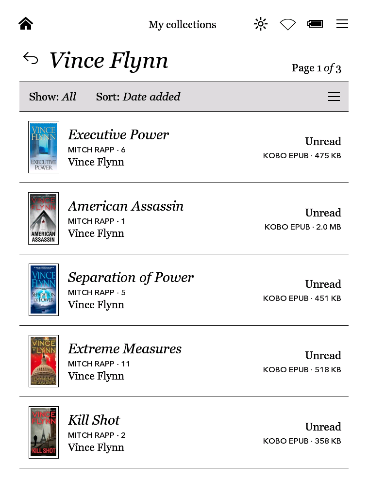

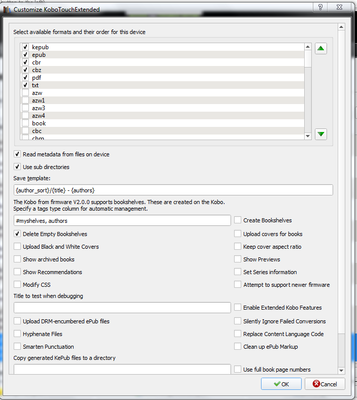

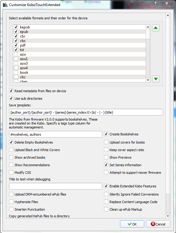

I assume that first lise is the collections columns and the second is the the metadata plugboard you use
I set that in Preferences -> Advanced -> Plugins->Device Interface plugins section->Kobo Touch Extended.
If the above is the metadata plugboard used to set the title in the device, when you select "Title" sorting on the device, it should sort the series books together in the series index order.
I tried sort Title and it didn't work.
EDIT: I thick it's not possible to sort by series like i want (Mitch Rapp-1, Mitch Rapp-2...)
because there not (sort:series).
Thanks David

Ok, the second line is the save template? Ok, it looks like a template commonly used for the title in a metadata plugboard.
Yes, there is no option to sort by series. The solution a lot of people use is to change the title when sending the book to the device to include the series info. This is done with a metadata plugboard. These can change several parts of the metadata as the book is sent to a device. The first post has instructions on how to do this and the example uses the template you listed. Once this is done and you resend the books, or use the Kobo Utilities to update the metadata (you need to select the "Use plugboard" option), the title sort will do what you want as the series info is part of the title.
