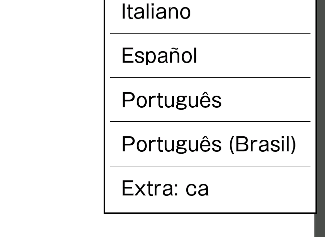

It works perfectly with Catalan and do not need to replace the Spanish .. Thanks
Good to hear. And it was pointed out to me elsewhere that the locale should be "ca_ES" with appropriate changes to the file name. Apparently, this will work better. But, I have no idea in what way.
