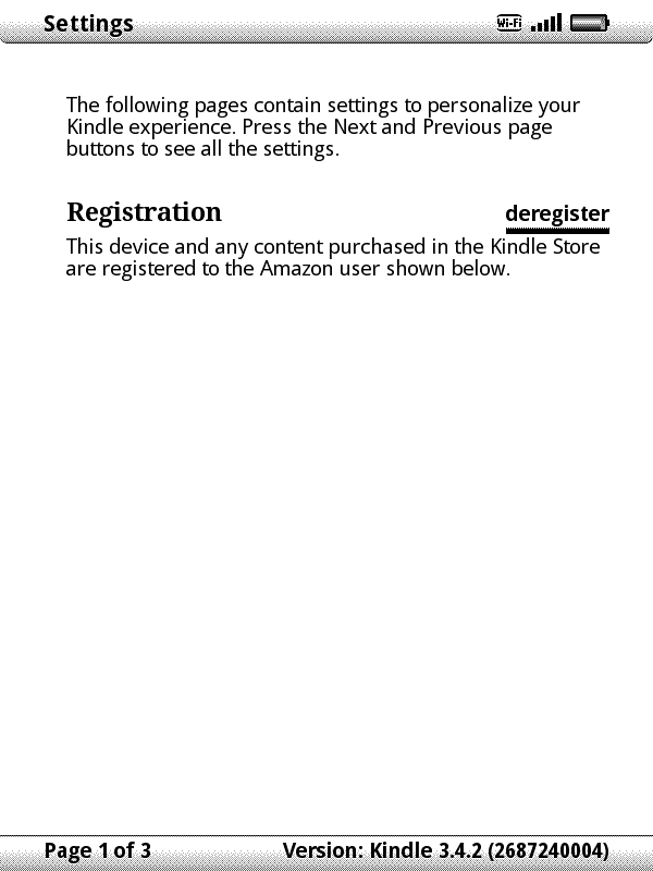

Documenting, If it can help.
My firmware version:

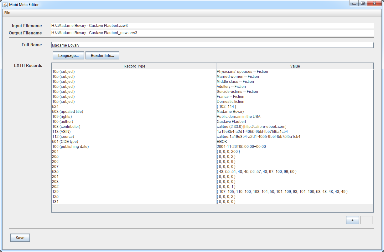

The specific (public domain) book I tested:
Madame Bovary - Gustave Flaubert.azw3
Its metadata:

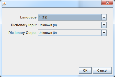

Its metadata language:
Name:	Mobi Meta Editor Language.png

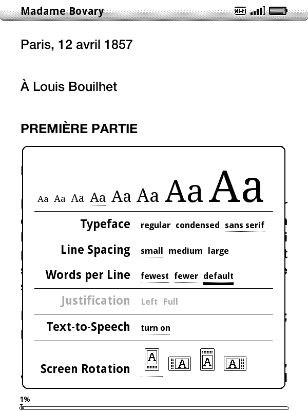

TTS enabled in my Aa options on this book:
