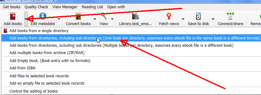

It isn't a setting, but is instead an option when adding books. See the attached screen capture.

All the books I have added so far was drag and drop onto calibre interface.
is it too late to change the previous ones now or can I do anything about it right now please

You can delete and re-add the books unless you deleted the folders they came from. If you did delete the folders then you should be able to recreate them from your other copy.

1-book-per-directory is meant to only import one book per folder. No wonder it adds only one book.
If you have multiple books per folder, don't use that option.
The primary use of that option is for books that have been in a calibre library before, and are already grouped with OPF/cover/multiple formats.
For new books yo can just drag-and-drop -- unless they are currently organized in folders already.
Do note: You can select a folder full of folders, for the one-book-per-directory option.
For backup, I would suggest using something like FreeFileSync/Synctoy to sync the library folder to your backup drive.
