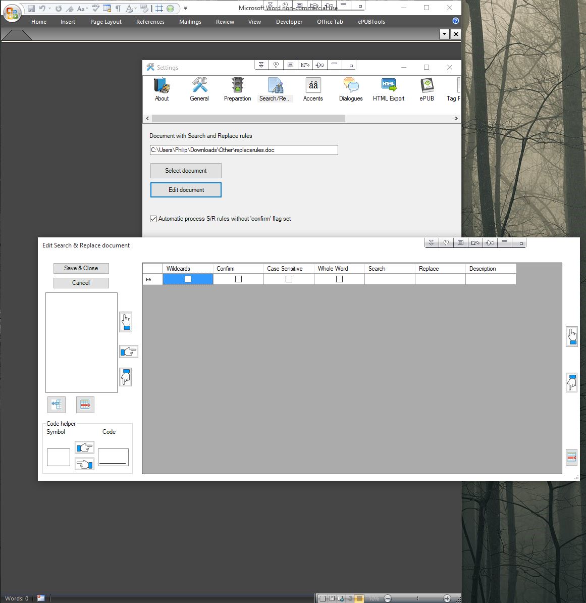

Search and Replace rules not being loaded to execute or to edit. Applies both my existing ones and the sample set downloaded from here ==>> http://toxaris.nl/en/,
C:\Downloads\Other\replacerules.doc is the one I just downloaded
I was looking forward to testing the the new Whole Word and Replace All features
Attachment 142483
Hmm, my tests worked all fine. Let me check some more and switch ruledocs in between some more. I will hunt!

I tried it and of course it works... That doesn't help finding the issue here. Can you see if there is a file ePUBToolsSRRules.xml in the directory %appdata%\Toxaris? That file is new and should be created if you choose another rules document and either save the settings or enter the rules maintenance. If that file is not there, it might give me a clue.

@Toxaris - ePUBToolsSRRules.xml is not there This is what is there:-
ePUBTools.backup
ePUBTools.cfg
ePUBTools.old
ePUBTools.backup
ePUBTools.cfg
ePUBTools.old
Ok, that is actually helping. Another quick question, if you change settings, are they stored? Leonatus is experiencing that changes to the settings are not saved.

@Toxaris - I changed a few settings - Dialogue Checking, Preparation, Ribbon, Small Caps, and Tag Formatting - the settings seemed to persist, i.e. they survived a Word exit and a Word start. I did a cursory test of Dialogue Checker functionality with changed settings - seems OK, so I assume the others are too.
So I reinstalled 1.12.2, as I did yesterday, I checked a couple of things to ensure I hadn't broken anything, Everything was OK. And then, for no good reason, I looked at the %appdata\Toxaris folder - by gosh, the previously absent ePUBToolsSRRules.xml was there!!
So I reinstalled 1.13 and did a test, without changing my replacement rules document, or looking at S&R settings. Seemed to work OK. Much faster to start and the Replace All works exactly as I hoped it would - I haven't checked out the Whole Word feature yet.
Yesterday all I did was -- install 1.13, run S&R which did nothing, tried, without success, to look at S&R settings; at that point I pulled the plug on 1.13. Today I did a lot more fiddling around with settings to ensure they persisted. But I did not look at S&R settings my assumption being, since nothing substantive had changed since yesterday, S&R would still be broken today . All very strange, but Word add-ins are a bit of black art
I'll make necessary changes to my replacement rules document, and make use of new features in coming days. If you don't hear from me by next week you can assume it's A-OK, but I will try to remember to come back with a thumbs up before then. Rest assured I'll come back if it's not OK
BTW - big for making the S&R changes backward compatible with existing replacement rules docs - really appreciated.
