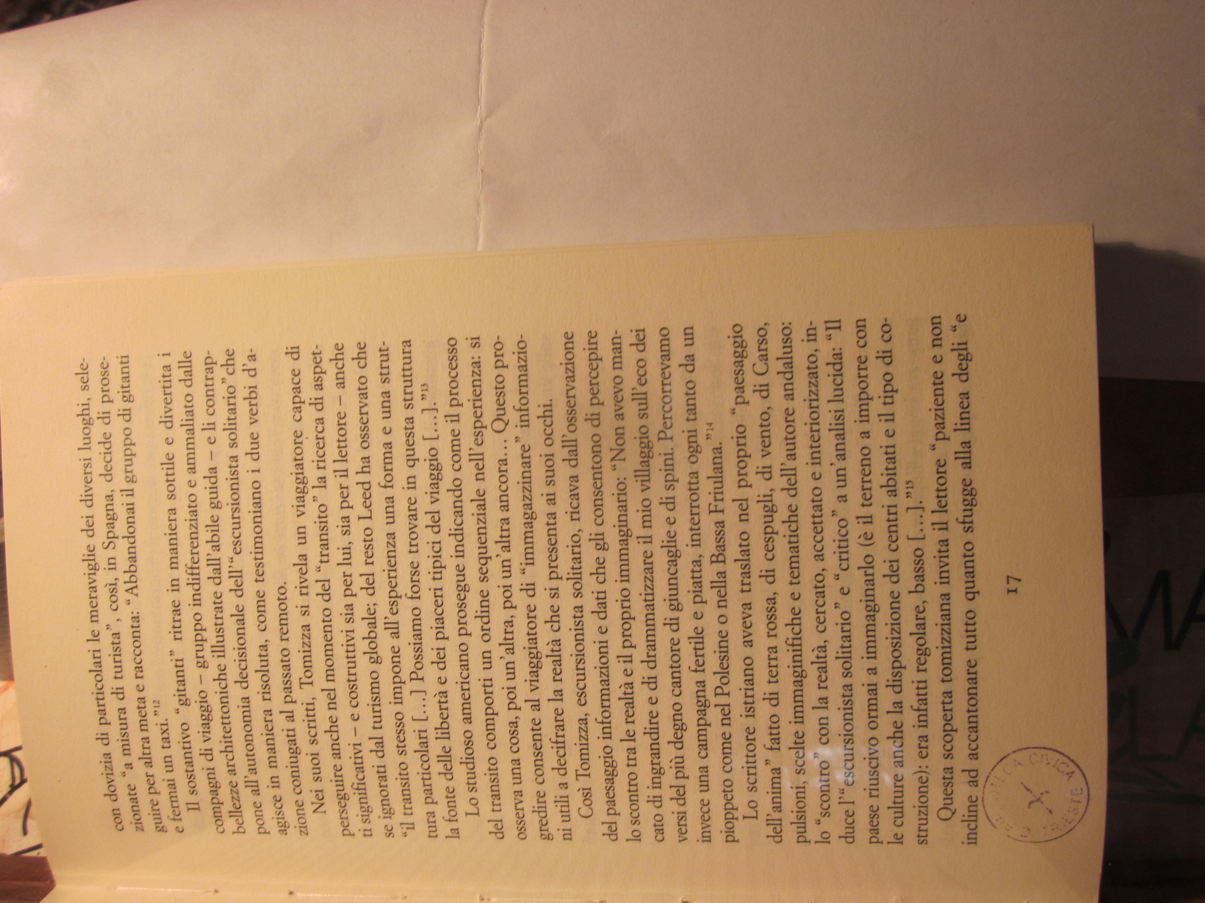

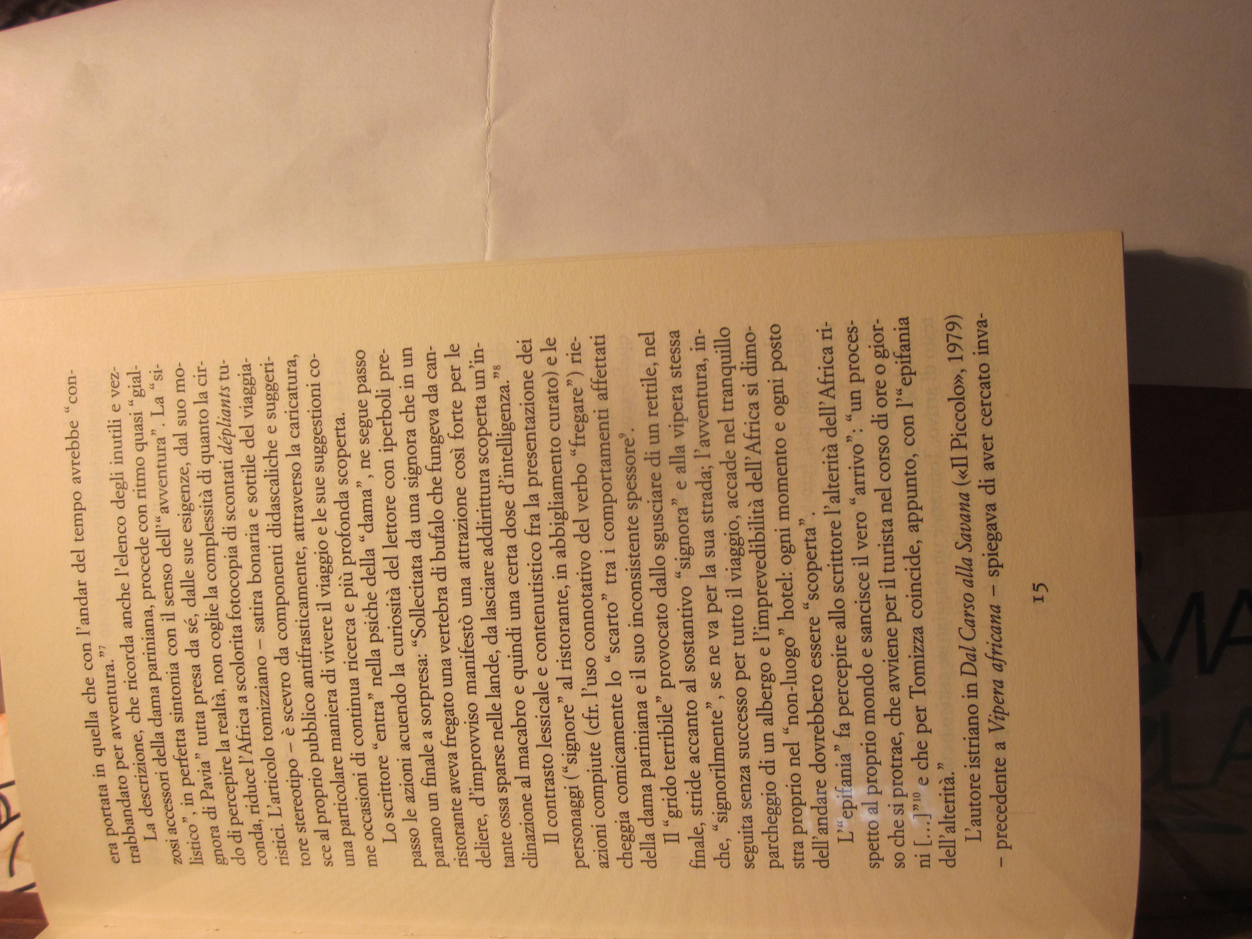

Yes it might well be my fault if it doesn't work. My manual skills are very bad.
I use AFR, which with a normal scanner works fine.
Anyway here's some pics.

Need more light. It looks like you are using a very yellow-tinged light source. Perhaps two "daylight" bulbs - with no shade - one on each end of the book.
And, if you can, zoom the camera so it is just taking a picture of the page instead of all the stuff around it.

Thanks, will try. Does it need to be a perfect rectangle?

And higher resolution if you can.

Higher res is impossible.
With stronger and whiter light (just one lamp though) it works better, thanks. It is still worse than the usual, and I'll have to figure out whether the whole process (including proofreading) is faster.

Cheap digitals do not have the color balance (setting) the Tutorial called for.
You must use Daylight (not fluorescent, which has lots of blue/green).
You really want the best possible contrast.
If the pages are yellowed, you need to correct the color WITHOUT losing the black (text).

The perfect-er the better-er!!
But no, it doesn't need to be perfect. The software can de-skew. Of course, the less it has to work at fixing that the faster it goes.
