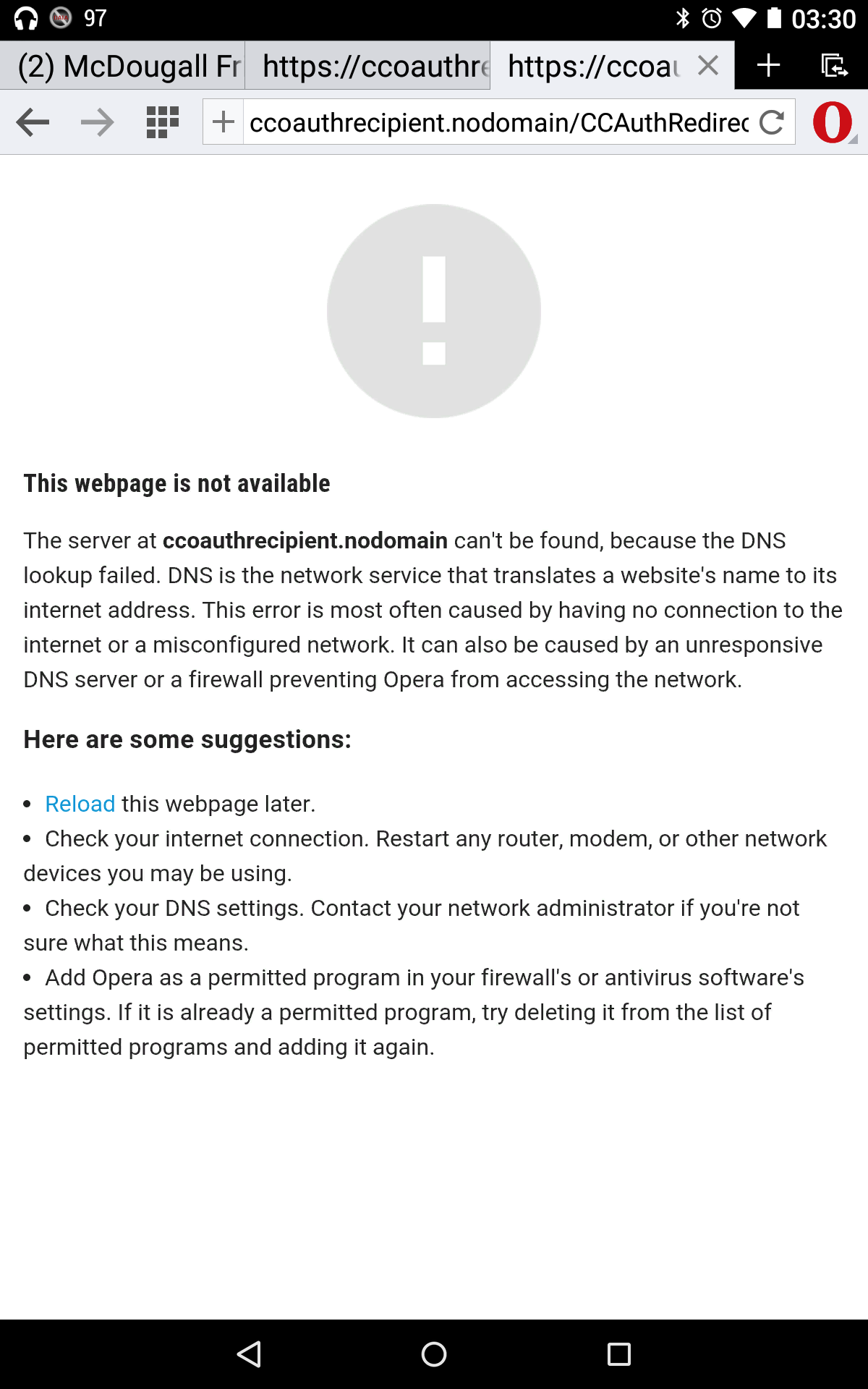

I had a similar experience when using Opera I got the error in the attached image. When I switched to chrome it was fine.
I am surprised that authenticating to or via the local dropbox app is difficult when coding for more than one cloud provider since it seems that multiple apps do it. I have to believe they can use other cloud providers as well.
Anyway I poked around and downloaded some books. I noticed the downloaded books were missing the Series metadata. I also saw that you will be releasing a fix.
In order to use the local app I must use their SDK (Software Development Kit). Every provider's SDK is different, sometimes fundamentally, so using the SDK makes supporting multiple providers much more difficult. The CalibreBox and Calibre Cloud people have both complained about this.
In any event, I am switching to an internal "webview" that takes care of the redirection.
I released the fix yesterday (V4.0.0b). Hasn't it been offered to you?
