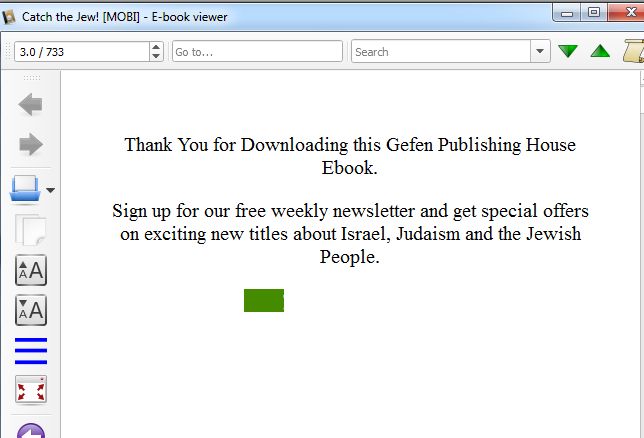

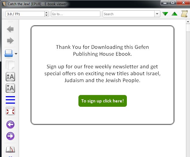

Hi Everyone.
I used the following code to add a link to a book page.
I added the page and the css page to to the epub file in calibre and it works fine. But when I use calibre to convert ebup file to mobi, the button and other design elements to not render. I am using calbre to view the books in each case. See attachments.
Can anyone help me with this?
<body class="calibre2">
<div class="box">
<p class="calibre3">Thank You for Downloading this Gefen Publishing House Ebook.</p>
<p class="calibre3">Sign up for our free weekly newsletter and get special offers on exciting new titles about Israel, Judaism and the Jewish People.</p>
<p class="button"><a class="a" href="">To sign up click here!</a>
</p>
</div>
ID:	139074   Click image for larger version

Originally Posted by akJtown View Post
I know I need to add the link their. I just left it out in the example.
But the problem is that the the button doesn't render and neither do the other design elements. It would seem that the css file did not get linked to the page when I exported the book from epub to mobi.
If you're talking about the original mobi format, that's because it doesn't support CSS at all. You can use some simple css for creating mobis, but anything that can't be converted to html 3.2 attributes probably isn't going to work. Certainly no css supplied button graphics, or fancy borders are going to work.

Remember that also the calibre viewer is an ePub viewer; mobi files are converted to ePub to view, so in effect you are going ePub -> mobi -> ePub.

Thanks for your help everyone. So basically what I am hearing is that that if I want to add a page to a book using calibre, and then convert it to mobi, I should not use any css, just html. Is that right?
And would the same go for pdf? I seem to have a problem when converting my epubs to pdf as well.
Not Quite
Your CSS can (and should always) be any Valid EPUB2 CSS.
Just don't expect a DOWN (to HTML 3.2 rules) conversion to always work out pretty.
There is a reason that some publishers do (not just a simple: Convert) multiple versions of a book. They want it to render a certain way.
Rule 1 for conversions: KISS. Don't do anything that causes those conversion issues.
Rule 2 Be prepared to release seperate format versions if you must violate Rule 1
IMHO a PHD button is a nice to have, NOT A must. Code as a simple link and be done with it. Note: depending on your sales channels, even that might be allowed.
