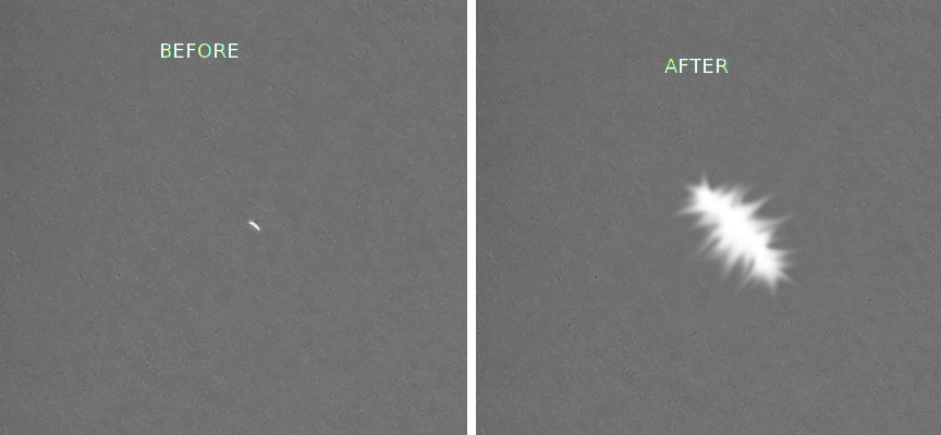

The result will probably look like this...
Light is evil.
You might have more success replacing the entire light layer, not sure if that's possible, maybe someone with a broken display could test whether the light layer can be separated from the display at all or not.

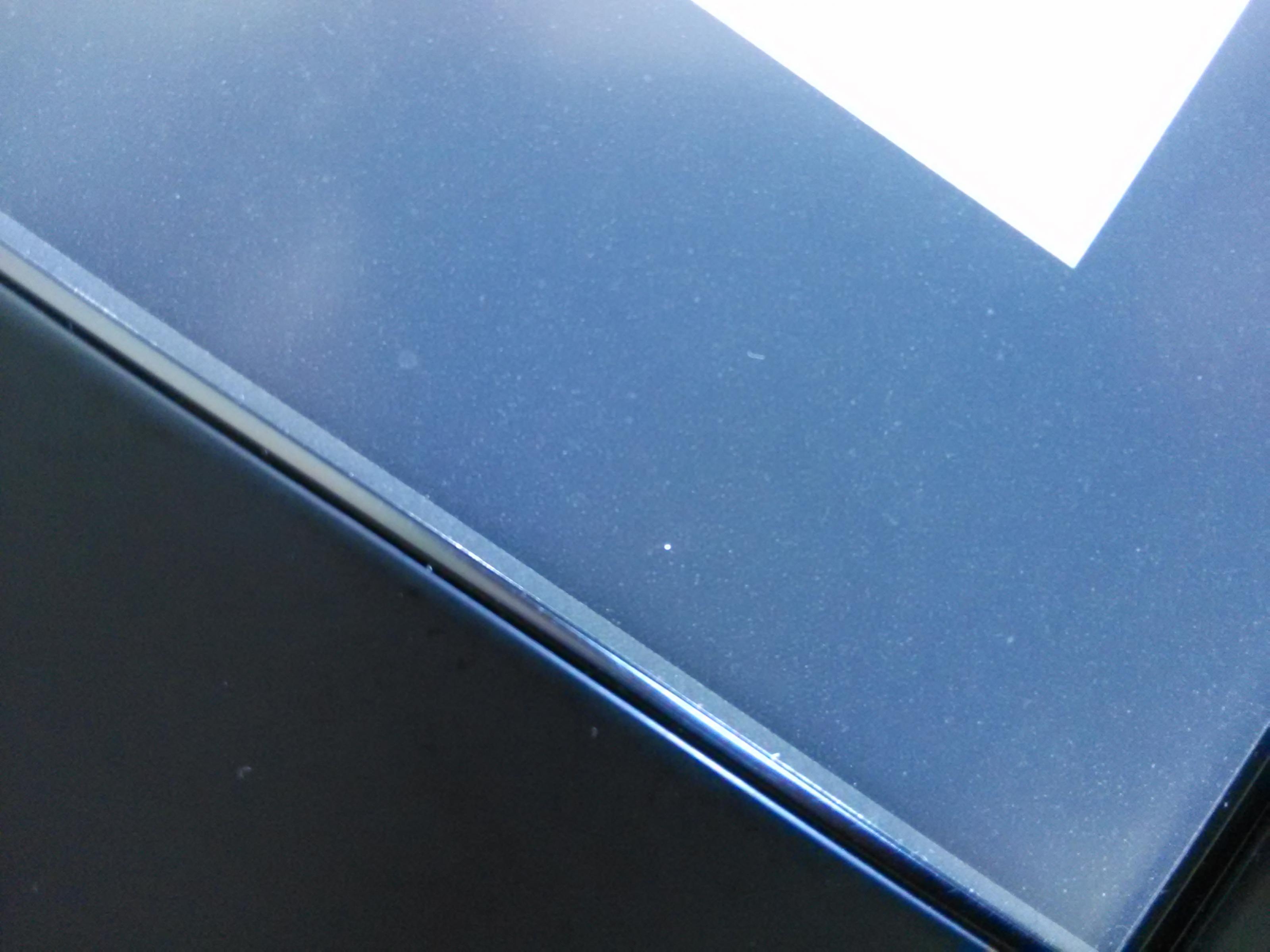

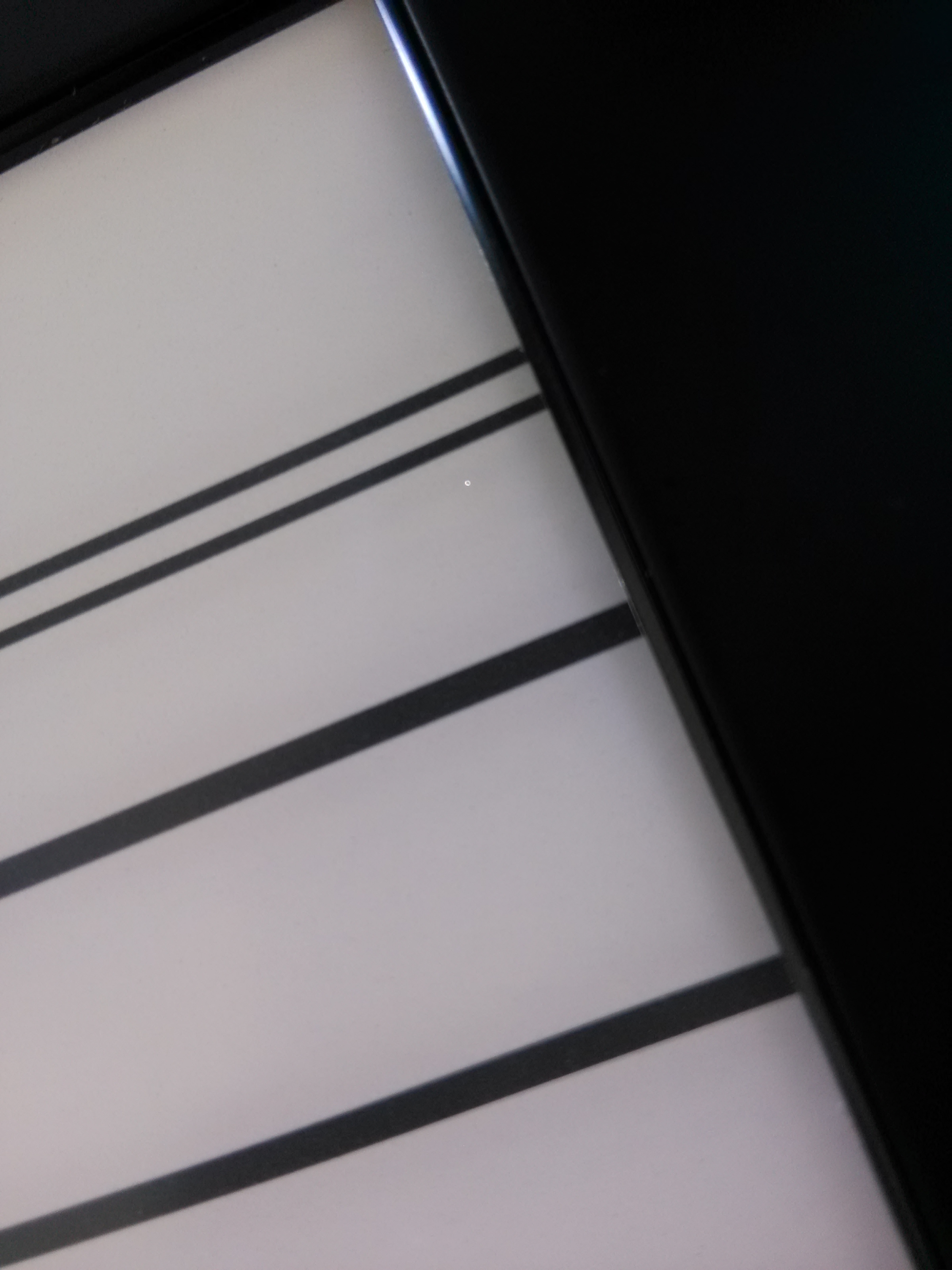

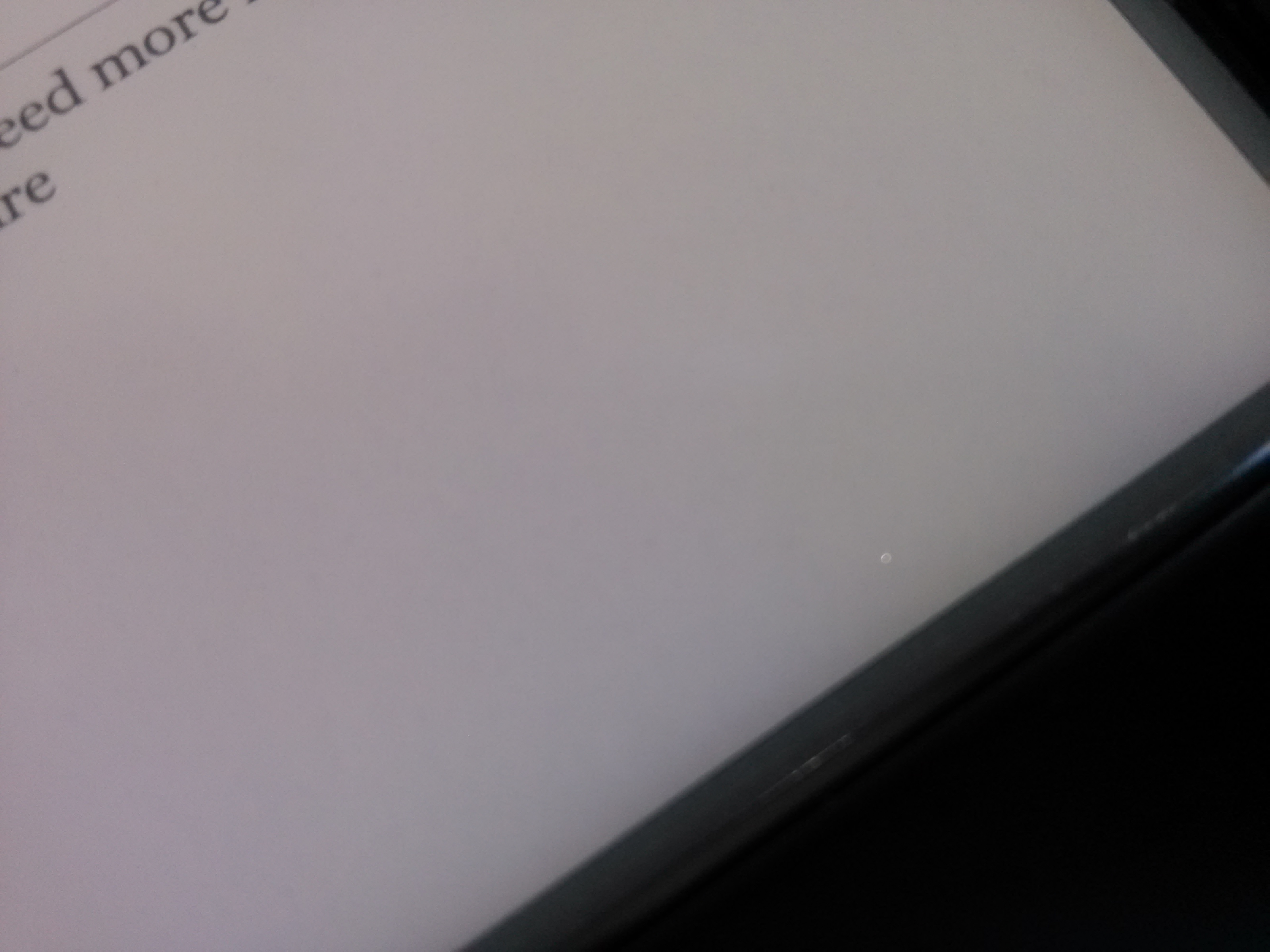

I just used the term used in the title of the thread, so decided to stick to it I know there's no such thing, it's the top "frosting" screen layer has a tiny damage.
The bright spot is visible on my Kobo H2O when the frontlight is on, see the photos. Returning it back to Canada is not an option, unfortunately.
@frostschutz, thanks for the answer.
@LeJon, no, that definitely is not a screen defect. You can see the spot even on his finger.
Ah yep - assuming it's not muck on the screen it looks like a light guide defect or damage. A shame you can't return it, but at least it's off in the margin.
(I wish they'd change the subject line too!)

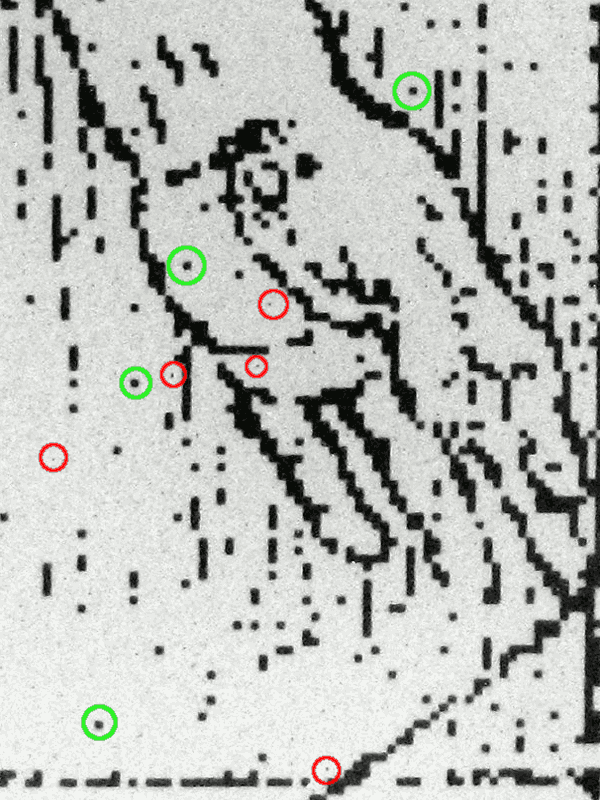

Bad pixels are entirely possible with eInk, but usually it's bad subpixels which you don't really see with the naked eye since their size is considerably smaller than 1 pixel. Not all of the millions of ink particels move the way they're supposed to.
