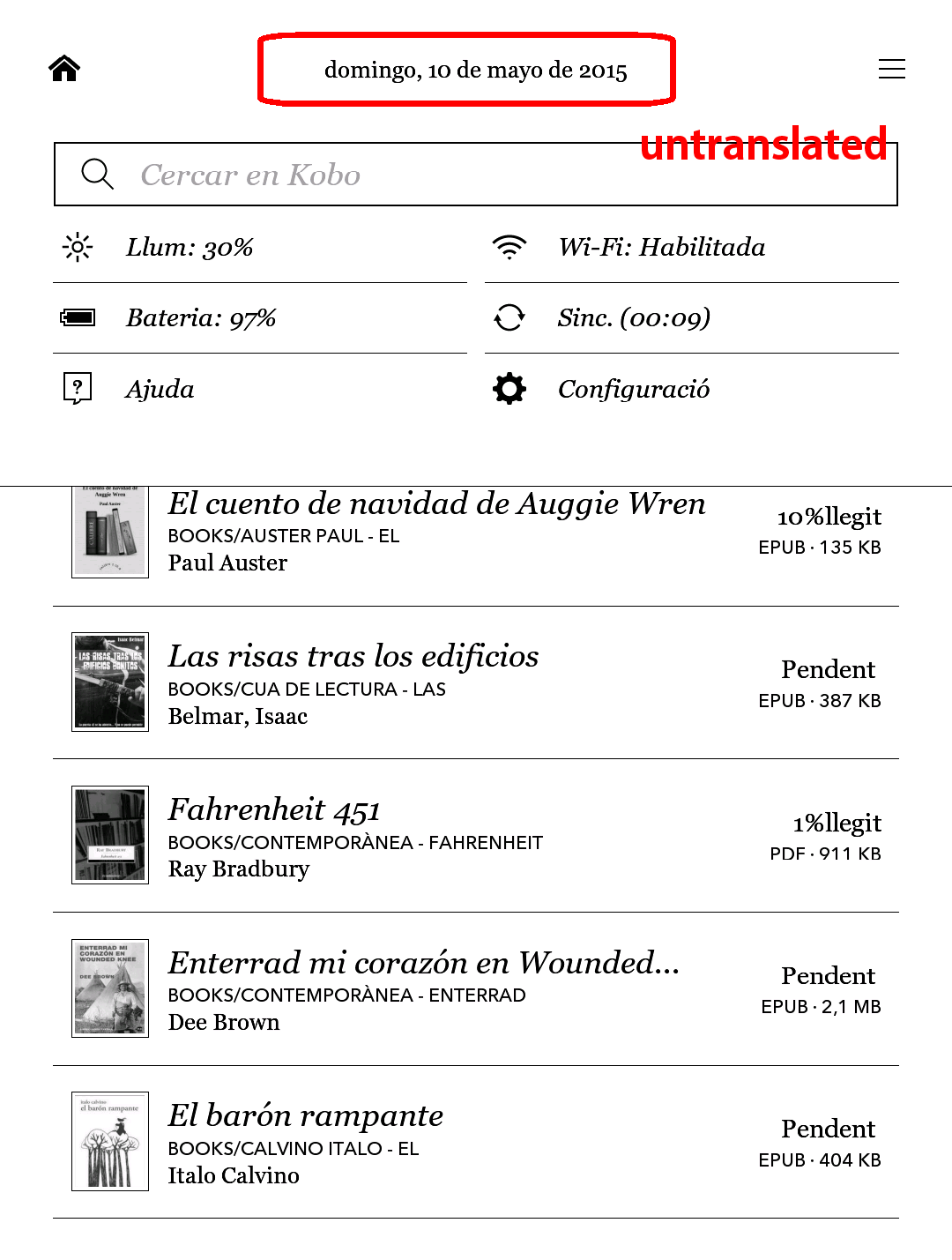

Originally Posted by surquizu View Post
I see Not are translated the dates (month and day). I guess they're not in the nikel file.
Could you point me to an example? First I thought you mean for instance 1/23/15 against 23/1/15. But now I think you mean something else.
Nor it is translated a phrase that warns that a dictionary is not installed.
I see three strings related to this topic.
DictionaryEmptyState{ref}You don't have the %1 dictionary installed. To add one to your eReader, tap Manage Dictionaries.{tr}No tens instal·lat el diccionari %1. Per afegir-lo al lector, prem Administrar diccionaris.
DictionaryEmptyState{ref}You don't have the %1 translation dictionary installed. To add one to your eReader, tap Manage Dictionaries.{tr}No tens instal·lat el diccionari de traducció %1. Per afegir-lo al lector, prem Administrar diccionaris.
InlineDictionaryView{ref}You don't have a %1 dictionary installed. You can install dictionaries from the language settings.{tr}No tens instal·lat el diccionari %1. Pots instal·lar diccionaris en les preferències d'idioma.
Are you saying that those strings do not have an effect? Or are you talking about another message?
See images attached 1 and 2.
These three strings and other about dictionaries on are well translated. The string untranslated is the image attached No. 3 (image No, 4 is the same in English).

The dates are probably coming from the standard libraries. Try setting the locale in the config file to something appropriate for your country and language. Look for "CurrentLocale" in the config file and change the value. From what I can see, the value should be "ca_ES".
Very nearly. With ca_ES, the date is translated to Catalan, but disappears the rest of translation and placed in English. If I apply again the Spanish language (translated into Catalan) the date is again untranslated.
That is annoying. My guess is that it is using the locale with the other libraries that do translation themselves, but defaulting to English if the locale is not one that nickel has. The only things I can think to do is either replace the English translations with yours, or find the code that does the selection and change that to use ca_ES.
