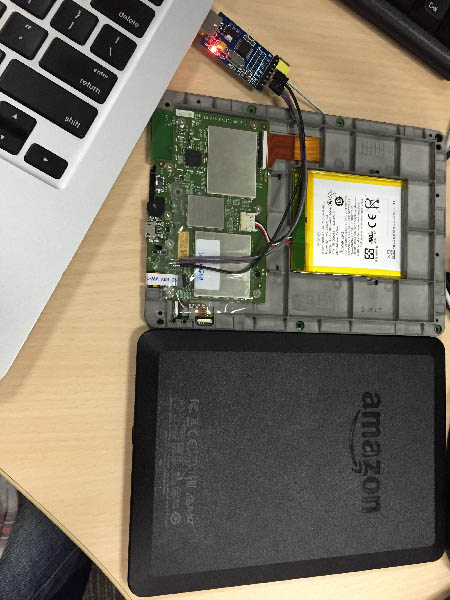

I jailbreaked my kindle 7 ($99) by TTL2USB serail!
Boot up to dialog mode by bootm 0xE41000 and login root with passwd 'mario'.
Then I removed the main mode root passwd in file /etc/shadow of mmcblk0p1.
I already got root access of the main boot mode, installed jb-1.14.N and KUAL. I'm able to launch KUAL.
