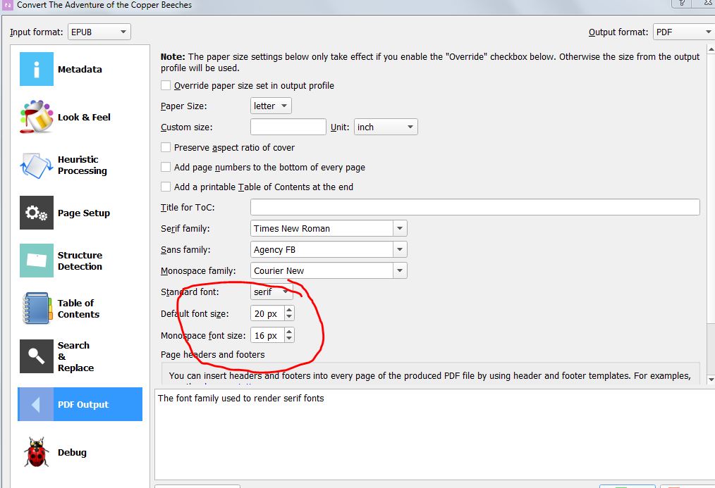

1. Converting to PDF with all defaults generates an unreadable file with huge font (ePub2PDF Conversion.pdf). The [PDF Conversion] settings use 20px and 16px (PDF Conversion.jpg) and I really don't think that's done correctly.

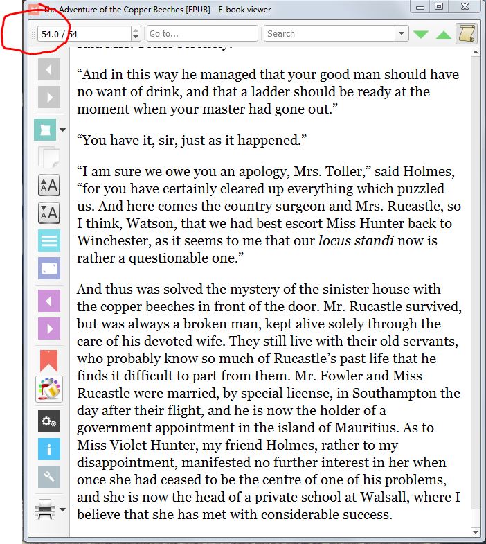

2. Also recommended was to use the [Print] capability in the Calibre viewer and print to a 'PDF Printer'. Again with all viewer defaults and printing to the CutePDF pseudo-printer, only the first 2 pages come out and the 3-18 are blank (Print to CutePDF from Viewer.pdf)
The viewer shows "54.0 / 54" pages, but I assume that's really screens, but I don't know why it has a decimal value in the current page (i.e. the 54.0)
Any recommendations or setting changes will be much appreciated.

Name:	PDF Conversion.JPG
ID:	137570   Click image for larger version

@kovidgoyal -- Thanks. After I changed the Preferences - Output - PDF, I forgot that I had to [Restore Defaults] on my test document (since I had new defaults)
I confess I completely missed this part in the manual
The first, most important, setting to decide on when converting to PDF is the page size. By default, calibre uses a page size defined by the current Output profile. So if your output profile is set to Kindle, calibre will create a PDF with page size suitable for viewing on the small kindle screen. However, if you view this PDF file on a computer screen, then it will appear to have too large fonts. To create “normal” sized PDFs, use the Override page size option under PDF Output in the conversion dialog.
To set page margins, do I have to do it on each individual document? I believe I do since the [Page Setup] and [Look and Feel] seem to be [Common Options] and not specific to a format. I was thinking of adding CSS for margins to the Extra CSS field in [Look and Feel], but again that's in [Common Options]
Q1: Would it be possible to add Margins at least to the [Output] - PDF part of Preferences since PDF is the format that is least useful to an ereader and most often intended for paper output?
Q2: Instead of selecting from the list of installed Fonts, could there be an option to use the font in the epub? I find I almost always embed a font in the epub that I find readable on the Kindle (after AZW3 conversion of course) to select Publisher Font on the Kindle?

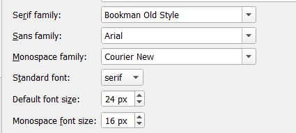

1. Perhaps under [Common Options] - [Page Setup] you could add PDF as an 'Output Profile' with the page size; the existing margin selections would work just fine
2) All fonts referenced in the input document are used automatically, unless they are not found on your computer, in which case the fallback fonts in that section are used. The only exception is the CFF fonts on windows because of limitations in Qt.
2. So if the CSS specifies font-face and font-size then those are used in the PDF, not my options? I tried to eyeball the resulting PDF and that's what I thought was happening.
3. Out of curousity, why are the font sizes for PDF in pixels, and not points. I would think that points are more common for a 'paper oriented' output since pixels are more ereader screen oriented.
Thanks again for taking the time to explain things
